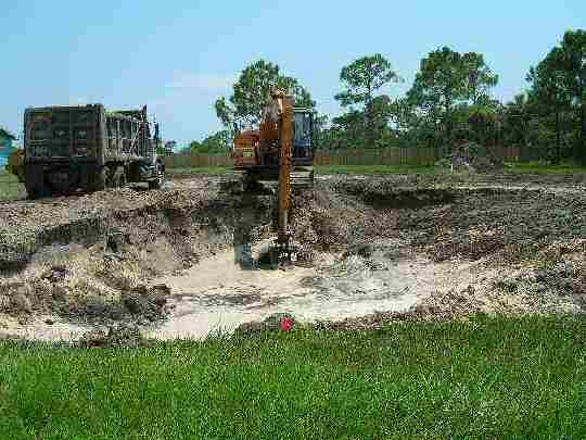

A couple of hours later, progress is being made. The hole is already starting to fill with water. It will be near the top in the morning.

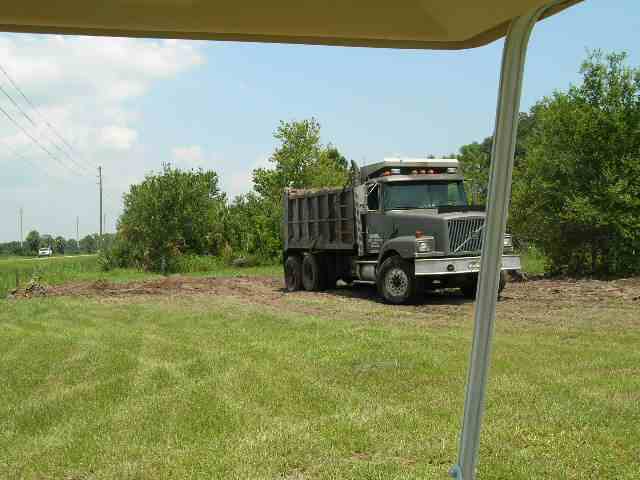

As the truck is loaded, it travels across Amy & Doug's yard and backs up to the low area on my property.

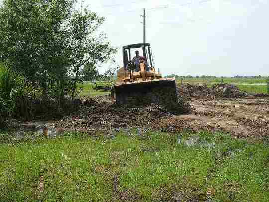

After dumping the load, the truck driver places the truck under the excavator bucket to get refilled, then jumps on the loader and spreads out his previous efforts. No wasted time, here...

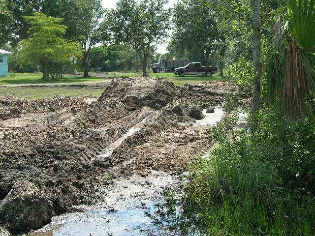

This is what he is spreading the dirt into. The water is displaced and absorbed and turns to soup. He runs the loader over it to compact it. We won't be doing any construction here, and as it dries, it will more-or-less compact itself even more, so we don't have to worry about the height of a lift or vibratory compaction. Most of this area will actually end up being a vegetable garden for Grandma Betsy and her 3 grandchildren next door to share. They're 5, 3 and 8 months, so she should have years of sharing ahead.
You can see the truck parked next to the excavator in the background, which is an indication of how far we are moving the dirt.

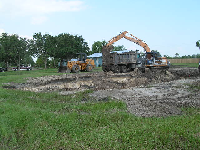

This is close to the end of Day 1. About 1/4 of the expansion is complete. Things will go faster tomorrow (which is actually today as I write this). The old pond is on the far side of the loader. They will dig the new pond towards it, then pump the water down quite a ways and take out the land plug between old and new.
