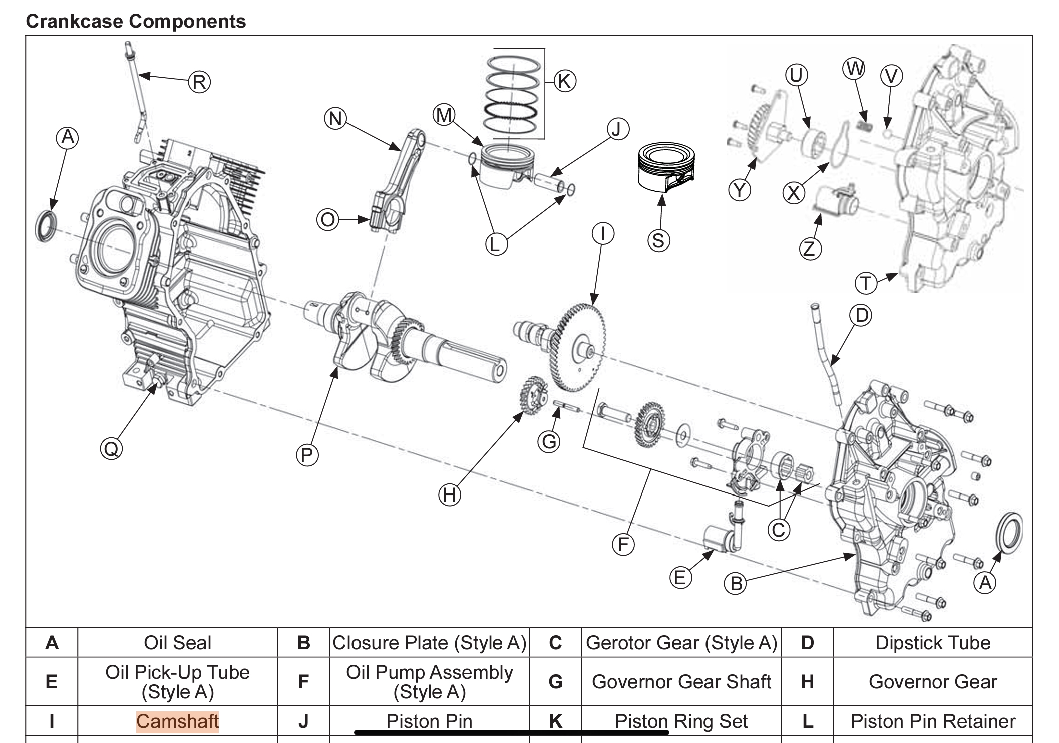

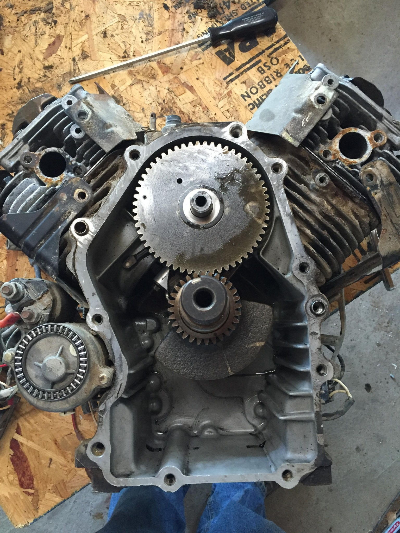

A large backfire certainly makes me think of timing issues. As your engine is a gear driven camshaft, a bent push rod could have done some damage. Did you find any metal when you drained the oil?
