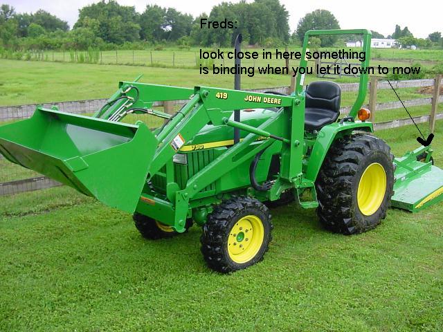

I have a stupid bushhog question. No sense starting a new topic.
What is up with the rear wheel being mounted so the pivot point is on an angle? I have everything greased and moving freely by hand when the deck is raised, but whenever I make a sharp turn the wheel just skids along sideways and tears up a chunk of turf. My BH is a KK.
Has anyone here tried cutting and rewelding the brackets for the rear wheel so the pivot rod is more plumb? It seems like that would help.
Thanks,
Fred

<font color="blue"> whenever I make a sharp turn the wheel just skids along sideways </font>
I have seen others complain of the same problem. However, mine turns freely when I turn. And it even completely rotates when I back up. If it turns freely when off the ground, there must be something binding somewhere due to the weight. It's possible that the angle on mine is not as great as yours.

Freds:
The angle is spose to be there, look at most caster type wheels there is almost always an angle.
Recheck the part of the mower where the back wheel brace goes through something in there is bound wheel should spin 360 deg. with load or not (K.K mower probley has bushings top and bottom, make sure a bushing doesn't have a good sized burr on it or welding slag binding on it)
Whiskey

Mine rotates, also, when I back up. It's just when I turn sharp that it skids.
I'll check into something binding when I put it back on. It turns freely when it is raised, so you have me thinking, Whiskey, that it's in the lower bushing that I might have a burr. When the weight is on it.
Thanks
