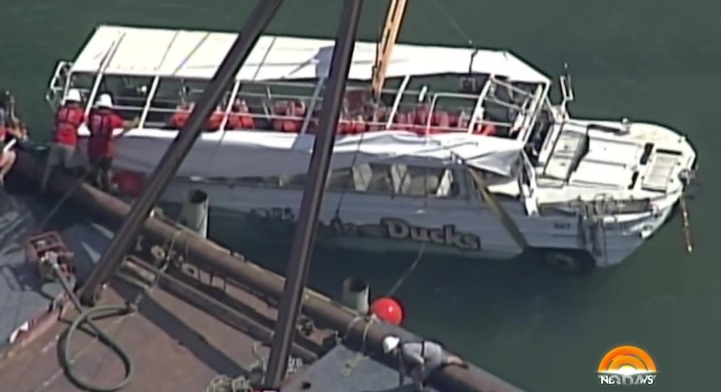

In the picture that BCP posted, you can clearly see the hood that I was talking about being propped up. In heavy seas, that's a water scoop. I still suspect that may have been a large part of the problem, especially since one boat negotiated the same heavy seas without sinking, or even taking on water as far as we know...

Yes. The exhaust exits the hull at the top of the tubes shown in the pictures, and blows out the bottom. The top of those tubes is probably 2' above the normal waterline, which compares well to a normal boat's upturn. Even if submerged, so long as the engine was running, water will not backflow and create issues. With the engine off for a long enough time, and the nose completely submerged, you MIGHT eventually get the exhaust to fill with water and get to the engine, but that's not related to anything that went on, and at that point, you're already fubar.
Look at that hood again... Big water scoop if it isn't sealing well. It almost appears that it can be raised and lowered remotely. Hopefully it wasn't something so simple as the driver or captain not noticing that it was still open...

The PFD's are not self inflating on the and they didn't "come with it in WWII" either
PICTURES: Sunken duck boat raised from Missouri lake
Note: the engine "hood" is NOT open. The PFD are evident, and the canvas top of the duck boat is opened up. Just when that happened I don't know.
Top view showing roof frame, from:
