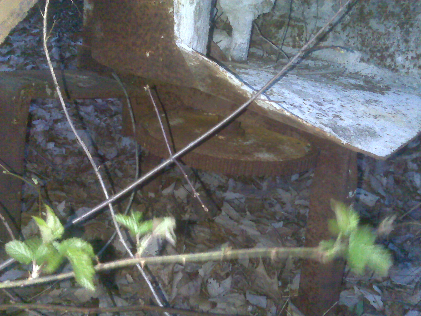

I just walked down the trail to the mixer and it is a Stone Construction Equipment model 650PM..
And it was modified to run on a PTO.
Below are 2 pics---
As you can see it has been sitting in the weeds for awhile..
I had pulled it out about 7 months ago, but stuff has already grown around it again..
It looks rough. but it may be salvagable.
there was a PTO shaft in the barn that looked out of place until I saw how the connection was..
I'm gonna go down with the tractor and get it Tue or Wed based on the weather.
now that I realize it was a "special" build... I am little concerned about PTO damage.. Gonna go and get some shear pins for the PTO connection.
Time will tell..
Once it's up on the forks and can get better pics, I'll post more..
