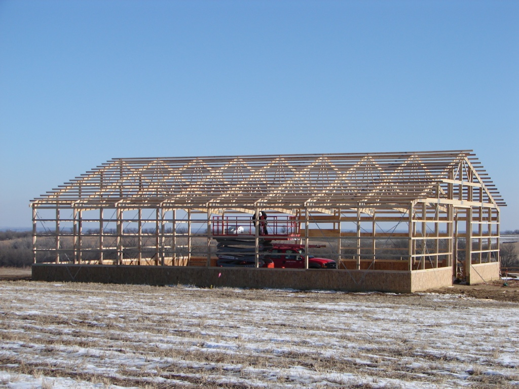

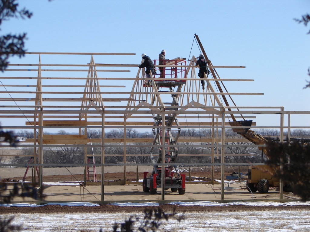

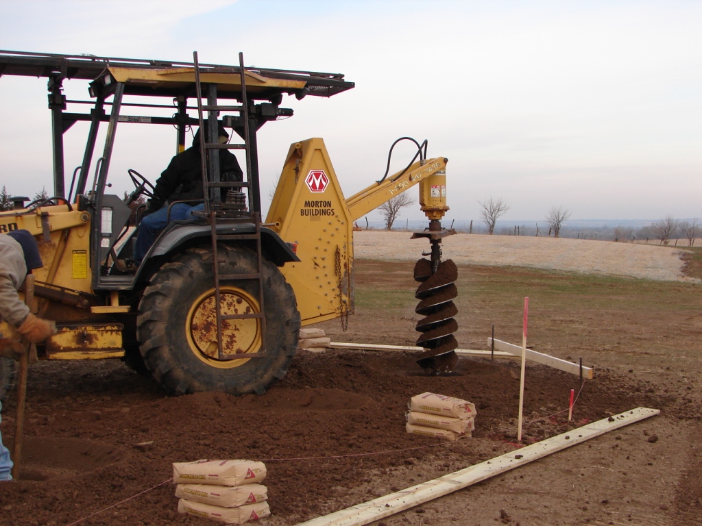

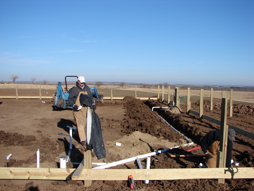

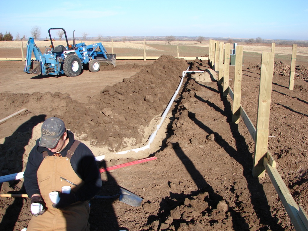

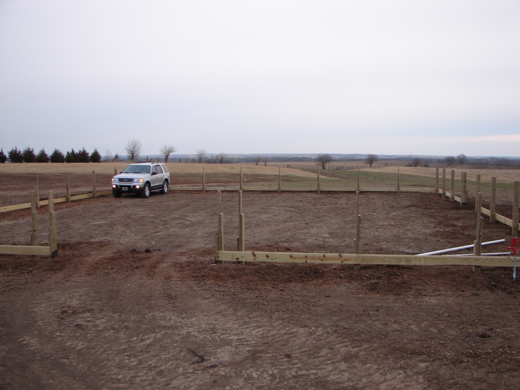

Photos of the 60' x 72' Morton in progress.

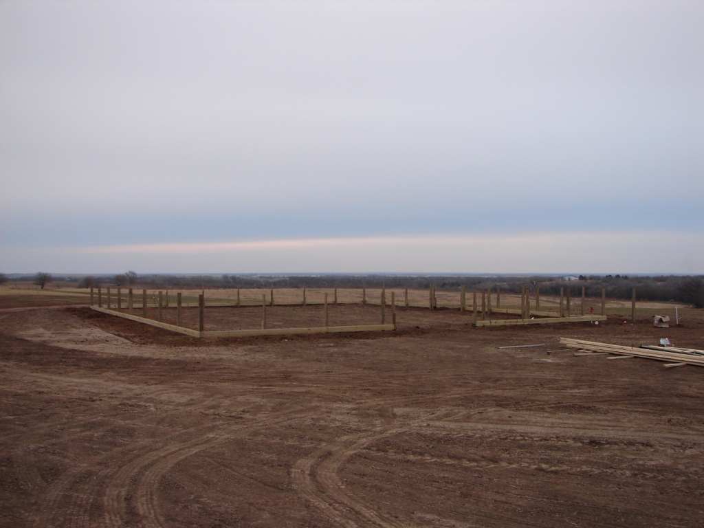

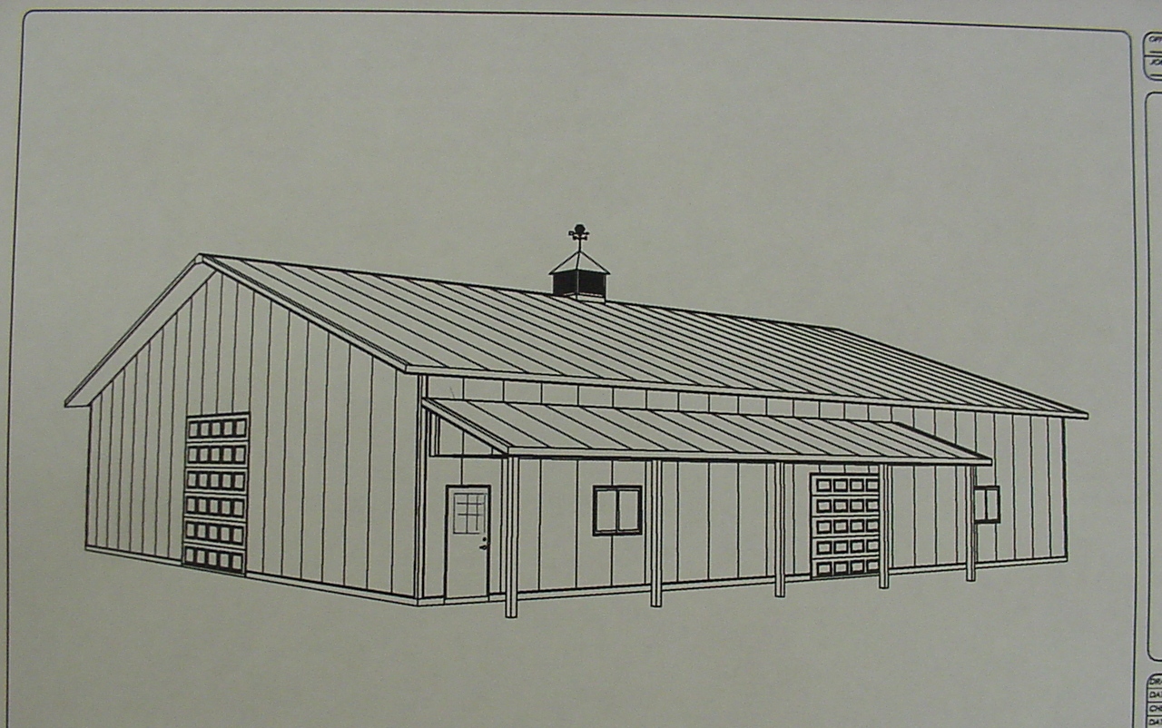

Two more:

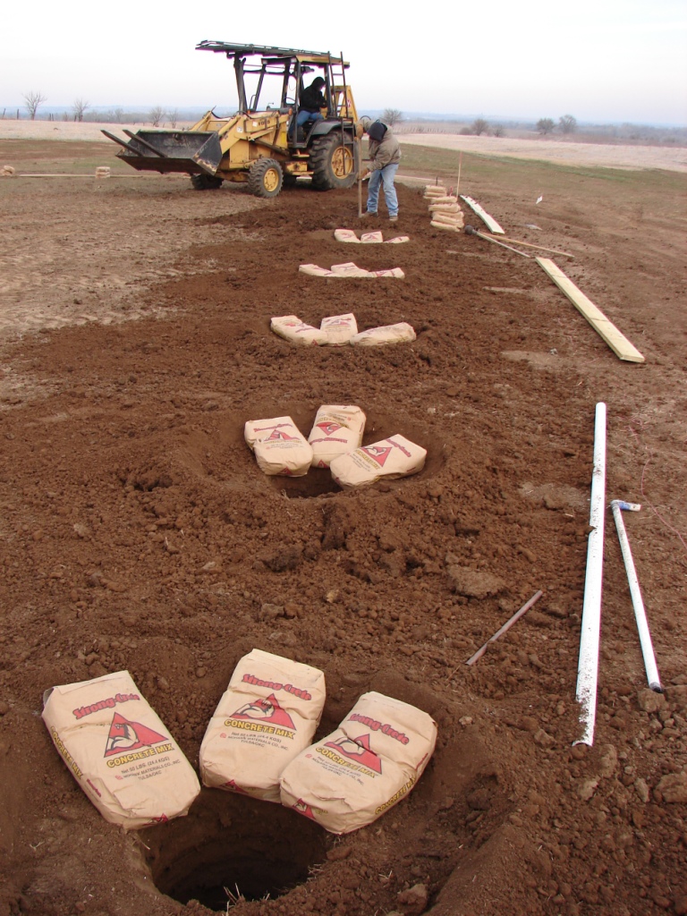

The weather has not been very cooperative the past month or so; but they got started again this week. See Photos.

Are your post set in the slab or on the outside of the slab?
If you get a chance some close-up pics would be appreciated;) :D .
/ Morton Building #12
That's going to be a great building! I did a bit of building research before we sunk so much money in the house. Morton seemed to stand out from the crowd as a premier building. Their equipment shows their focus, I've seen the same sort of tractors up here on their sites. Very specialized machine!
Keep the pics coming, it's fun to watch. What's going inside? PVC is drains for something?

The post are set in the ground with 3 bags of concrete mix each. The splash board is then nailed to the outside of the post, creating a perimeter form for the concrete. When the concrete is poured ( 4 1/2" in this case ), it surrounds the post that were originally set. Hope the photos show what I'm trying to explain.

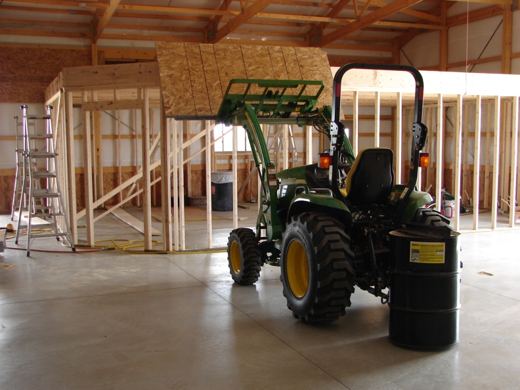

Two more photos for you:
A view of the finished building (obviously a lot of landscaping yet to do)
A view of the framed in living space (22' x 30') with storage up above.

Wow, what a beautiful building.
I'm guessing the process was slowed by weather and whatever else. Thanks for updating the thread.
Are you going to finish the interior? Are you going to "live" there, or is it a weekend retreat?
Your concrete looks nice a shiny. Did you top it with something?

The posts that are set into the ground consist of three treated 2" x 6"s nailed together, the remainder (height) of the post are regular 2" x 6"s and I honestly don't know if they were pre-assembled or if they were nailed together during construction.
I have finished the floor with a concrete sealant called "tiah" and I love the finish. Sweeping up dirt, saw dust, etc. is very easy.
The "lower protection" consist of 7/16" OSB and serves and protection from animals or other mis-haps that may occur.
The building is 60' x 72' and in the front corner where the walk-in door is located we are framing in a 22' x 30' living space with a stairwell along one end so that we will have a lot of storage space up above. The plan is to have a very simple living space where we can go for a couple of months when we begin construction on a new home. It will have a bathroom with 4' shower, etc.
I want to do some landscaping around the building as soon as I bury the downspouts. I'll try and post photos as I make progress. Next weekend I plan on putting up eight light fixtures in the main shop; One fixture is 4' long and contains four T-5 bulbs with a highly reflective surface to throw all the light down. Above the living space I will just install some regular old screw-light fixtures. In the covered porch area, I plan on putting can lights and on the front of the building a 150 watt metal halide wallpak.
