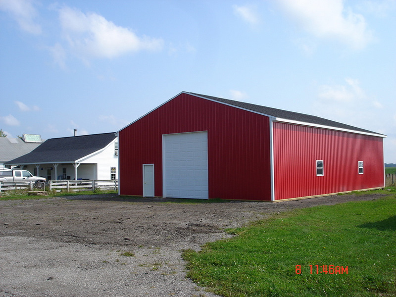

Using this method I bought a new 40 x 60 x 14 foot sidewall, 4 windows, one man door, one 12 x 13 insulated overhead door, 1 foot overhang, ventilated soffets and full length ridge vent, shingled roof with dimensional shingles to match the house, trusses on 24 inch centers designed for northern michigan snow loads material package for $13,625 delivered to my property all taxes included.
The materials came from a lumber yard over 100 miles away.
The labor to have it built was $4800. The erection crew came from 30 miles south of where I live, in talking to them they informed me that they travel up to 200 miles to do a job. They have built so many barns that they have it down to a science (and they work real hard). It is almost impossible for someone who doesn't specialize in pole barns to compete with them. The crew leader has been building barns for 35 years. They put my barn up in 3 1/2 days.
I awarded the concrete work to a local independent contractor, his bid was only $130 higher than the lowest bid, but our area is suffering greatly from the overall economy, the unemployment rate is over 20% and for the small difference it is worth it to me the keep the money in our comminity. I got a great barn to replace the one I lost in a fire. I think I got a lot of barn for the money spent.:D:D:D
photo 1 barn kit delivered
photo 2 progress day one
photo 2 progress day two
photo 3 done:cool:
photo 4 done!! they built the barn in less time that I spent replacing the 4 windows and the melted siding on south side my house:cool:
