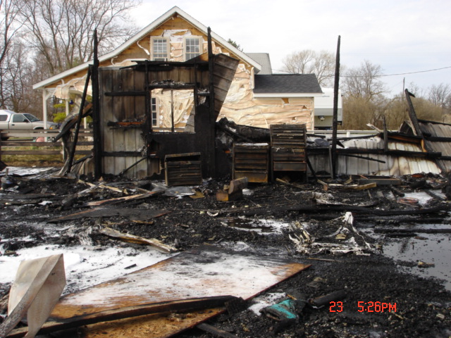

We have very cold weather here in Northern Michigan also. (I live 12 miles from a state snowmobile trail head) Most of the barns here have concrete slabs that are installed on top of compacted sand. We strip off the top soil and vegitation and backfill with sand. If we build on the clay sub soil without the sand, the frost heaves and the swelling of the clay from water absorbtion quiclky cracks the concrete. The pole barn poles are set on round concrete solid blocks to spread the load to the undisturbed soil below. The floor is just a floating slab without any kind of foundation.
This is a before picture
I had to add to the existing fire damaged slab and repair it, this link shows the final results. Considering the mess I started with, I am very pleased with the results.
http://www.tractorbynet.com/forums/...-need-advice-tractor-needs-6.html#post1764993
