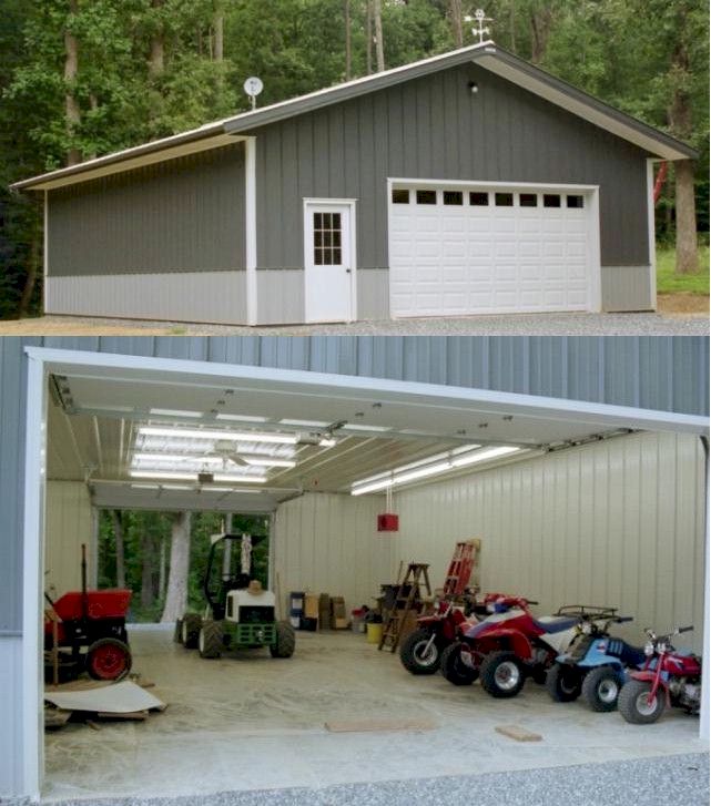

"" Morton Buildings......Top Quality...Professional ""
Sorry to hear that you had a bad experience with Morton, but with about a hundred offices (not dealers or franchisees) all over the country there is bound to be some bad apples in the barrel!
Morton just completed a 30 x 38 for me from their Lexington, NC office. I could not be happier! The price was great! The quality and workmanship are outstanding! The Foreman on my job has worked for Morton for 16 years, and his crew was top notch!
The only problem I had was that the mason, a subcontractor, mistakenly ordered 2 truckloads of 3500# test concrete for the floor. I had specified 4000# test. One telephone call had the 3500# sent back! Two hours later 2 trucks arrived with the 4000# concrete on board!! No problem, no hassle, not even a moan or groan!!
When the Building Inspector completed his final inspection, he said to me: "I've been an electrical contractor and building inspector around here for 17 years. What you have here is, by far, the highest quality, finest looking out building that I've seen built here in Orange County in those 17 years !!"!! I will take his word for it!!

   / Morton ploe barn-How square should it be ???? #85
That is a fine looking building. If you don't mind the question, how much did it cost ? I sure could use a building like that to store more of my "junk" in. It would take me about 6 months to fill one that size.... /forums/images/graemlins/crazy.gif /forums/images/graemlins/crazy.gif /forums/images/graemlins/crazy.gif

"" If you don't mind the question, how much did it cost ? ""
Of course not!!
I researched both locally and online for several months to find a building to suit my needs. The best one I found was at www.steelbuilding.com. A 24 x 32 x 10 kit for about $10,000 with no interior. Problem was that it had to be erected on an engineered concrete slab. I finally found a local contractor who would "give it a whirl" for an extra $30,000!! Forget it!!!!
I had always heard that Morton Buildings were superior, but I didn't think that I could afford one! I was soon to learn otherwise!!
My Morton representative helped me design my building:
Building 30' wide by 38' long by 10' high (twice the size of a 24 x 24 garage)
Dark Gray, Light Gray, & White Roof
Steel Walls and Roof
16 x 8 Ins Steel OH Door w/windows & Genie Screwdrive Opener
12 x 8 Ins Steel OH Door w/windows & Genie Screwdrive Opener
3' Ins Steel Walk Door w/window
2' Eaves & Overhangs
full Gutters & Ridge Vent
4000# 4" concrete floor
I provided a flat building site, and did the electrical work. Morton did everything else, all building permits, labor, and materials!
PRICE = $23,322!
To this we added the Morton Energy Performer Liner:
Complete Steel Walls w/Girts & Vapor Barrier & R-19 Ins
Complete Steel Ceiling w/Vapor Barrier & R-30 Ins (actually R-35 was installed)
Morton Weather Vane
20 Electrical Openings
PRICE = $4,270!
TOTAL BUILDING COST = $27,592!!
The insulation really works! I open the doors in the morning for 2 hours with the temp ~70. Close up. By late afternoon it's ~90 outside, but only ~80 inside!
Hope this info helps.
As I have gotten older, I have learned that not everything is a 'Do It Yourself' job! Sometimes you're much better off letting the pros do it, with your close inspection! My Morton crew had so many neat tricks that, although not major items, added greatly to the finished product. For example, I hate the look of gutters, but by making the gutters and downspouts Dark Gray, installing the downspouts on the rear of the building, and extending the fasia trim over the front end of the gutters, they nearly disappear!!
Overall, this is about the wisest investment I've made! You are not really spending money on a building, you are investing it!! You are increasing the value of your property by more than the cost, and every day that value increases! Spend $30,000 for a new truck, and what will it be worth 10 or 20 years from now?? What will a nice Morton be worth by then!!??!!
