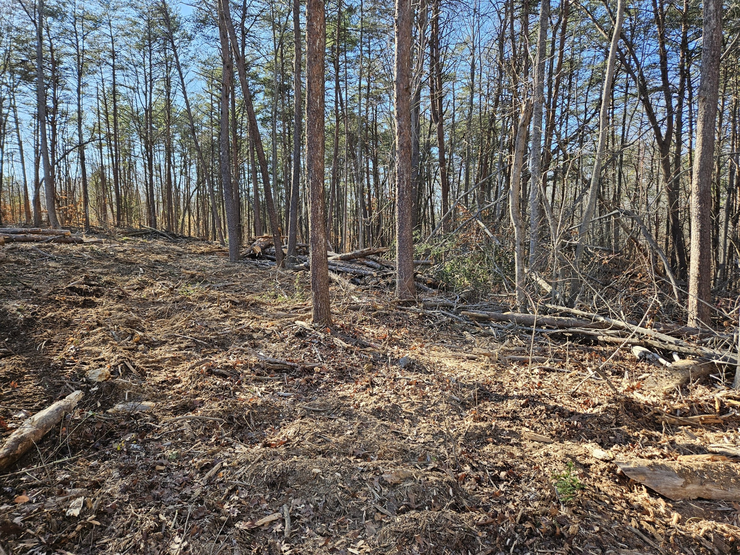

Working around family obligations, I got about 7 hours on it today.
there were two standing dead trees that i felled with a chainsaw for safety.
4 that were already windblown and tangled up. I used the ex to push them down to the ground and then bucked them.
22 or so that were standing normally. I tried digging one side and pushing. Worked but cumbersome and slow. I felled with the forestry mulcher at about 8 feet up leaving the rest for leverage. The ex was still slow on this. Ultimately I settled on felling with the mulcher leaving about 2 feet up. At full speed the mulcher had enough retained momentum to take the stumps down to ground level in one pass from 2 feet up. I took them all to ground level this way and stopped there to save my cutters. I prefer felling with the mulcher because I can't run away from the falling tree like i used to and trees this size can be pushed where i want them with the skid.
i then used the ex to lift the logs up and buck them with a saw (I'm not hunching to cut a tree), then stack them in a pile for later collection. I piled the slash seperately.
Once i had cleared enough to get the truck and trailer up there i started hauling logs off.
I worked until i ran the ex low on fuel then spent a full tank of fuel in the skid mulching the slash pile. I quit to get the kids from school.
All the trees are now down and cut into logs. The slash is 75% mulched.
I can probably finish it tomorrow but it will take a while to level the ruts from the skid (it has significantly more ground pressure than the ex, especially with the mulcher on it).
I'm thinking i may just leave the stumps where they are, about an inch below ground. Alternatively, I can pay my 15 year old to use the 3 point stump grinder on the tractor to take tge biggest of them 8 inches below grade. For a food plot/forest clearing I'm not sure it matters much. I haven't decided yet. I know for a fact the tiller doesn't care if it hits a stump, all the tines were redneck upgraded to 3/8 in angle probably before I was born and it's a gear drive unit that is fairly indestructible.
