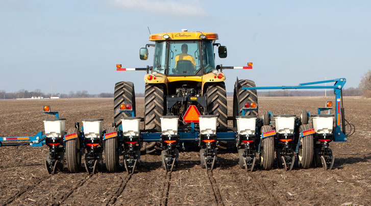

oh sure, I want 30" or a bit more straddling width between the front and rear inner tire walls to be able to straddle my 30" wide 8" high raised market garden beds. probably 27-30+ hp diesel, maybe a bit more if hydrostastic. Loader not needed, will be running 3 pt plows, cultivators, 48" rototiller, 8 row corn/large seed planters, 5 ft tandem disc, BUT I have a started plant trays transplanter that holds about 100 gallons of water and is heavy duty steel carrying two adults, it's fairly heavy and it requires hydraulic remote outlet support for lifting the hole making dibbing/watering wheel. I've gotta think the implement weighs 1500 lbs or so with the water tank filled up. Also I'm interested in pulling a 12 ft ground drive seed drill and running an older pull type small (5-10 ft header) pto combine for growing some small heirloom grains.
Maybe I am not understanding what what the implements are. I live in farm country. When I hear 8-row corn planter and 12' drill......Im thinking there is no way a 27-30HP tractor is gonna pull that.
Around here, those things are pulled with 100+HP 10,000#+ tractors that cost 150k. And probably 4 gallons of fuel per hour +. If those could be pulled by a 30hp/3000# machine that cost 20-30k, and only drin 1 gallon per hour, wouldnt we see more of it?
You may want to consider checking the specs on that 12' drill. You will be needing more like 60 HP for that and even more if it's a no till

I just can't agree bc they're old implements and ground driven. We ain't into no till around here. And My landlord used a farmall H gas to do the corn with one of those old JD 8 row units, that's like a 27HP gas which should be even less pulling power than the same HP modern gear driven diesel
ETA: MY BAD IT'S A 4 ROW CORN PLANTER. Anyway i don't think I'll be going for more than 35-40 hp so just interpret that as "he will find the right size implement for his tractor...he is not farming large acreages and really how small the implement is doesn't affect his time a whole lot one way or the other"
Don't confuse hp with traction. Many older 2wd tractors will out pull newer 4wd units simply because they weigh 5000lbs. All the horsepower in the world won't do any good if you are spinning the tires.
Newer high hp FARM tractors weighing 15,000lb + need duals to put the power down and not compact the soil. That high hp let's them pull implements at higher speed, but only if they have the traction
I'll guess that the Farm all H weighed 4000lb. If you want to pull the same implements you will need a tractor near that weight.
A farming friend told me once that HP is for PTO applications or Speed, weight is for pulling.
Spot on. That Farmall H was really made for 1 thing......pulling.
Modern tractors, especially in the 27-30 or even up to 40HP range are made to do may things.
I own a modern ~4000# tractor with 51HP. And can tell you....I would not want to chain drawbars to an H. Them tall 38" tires with 4000# have more traction than my 26" tires with the same weight setting on them.
