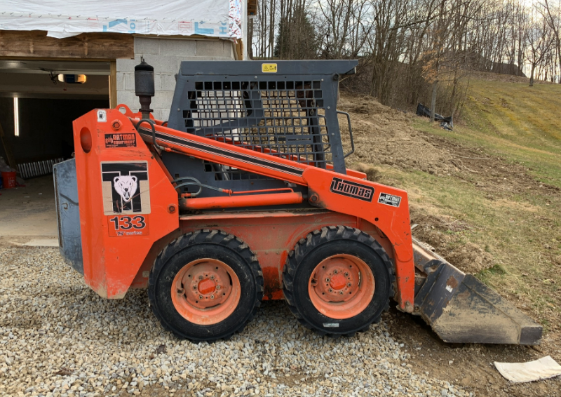

So I can pretty much use any 10w30 for the hydraulic system. It holds 8 gallons, soon I am going to change the oil and filter and don't want to go broke. If I can buy it in the 5 gallons buckets, it will be cheaper than buying it the gallon.

Remember though, I'm talking the hydraulic system and not the engine. I may be putting too much thought into this. When the skid steer was make, the motor oils were very basic back then. So I would think any type of 10w30 motor oil would work. My concern is damaging anything like seals, pumps, etc. but using the wrong oil. I think I am stuck on the mindset with Kubota. They are very particular on using SUDT when they state this in there manual. Now I have only owned and maintain fairly newer Kubota equipment, so that is my experience. BTW, to put a face with the name, this is the machine that I am working with. I put new tires on it last week. The old ones were in decent shape, but were badly dry rotted.

I did talk to an old dealer that used to sale Thomas. They said that as long as I use a name brand oil, I should be fine. They said not to use any off name brand.
   / Motor Oil for Hydraulic fluid #37
Earlier you asked if you were overthinking it. My answer would be yes, you are overthinking it. :)
If the manual calls for 10w30, any modern 10w30 you buy at Autozone, Walmart, etc... will work just fine.
