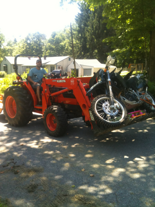

It's a little nicer than my "motorcycle loader"

I'd like to see a video of that in action, as I'm having a hard time seeing how it works and how the loading ramps come apart to make the tailgate close.
   / Motorcycle Loader
#16
I have to leave the tailgate at home as the bike is about 8.5 ft. long and I have 6.5 ft box.
The back of the part that is always in the truck is supported by the receiver hitch.
There is an attachment point at the front of the truck mounted frame to attach the winch cable.
The winch and battery are both mounted on the dolly. The ramps are attached with a 7/16" pin which is also used to
secure them under the bike and dolly for travel.
I don't have a video and I think this description is about as clear as mud.
Next time I use it I will try to get a video.
