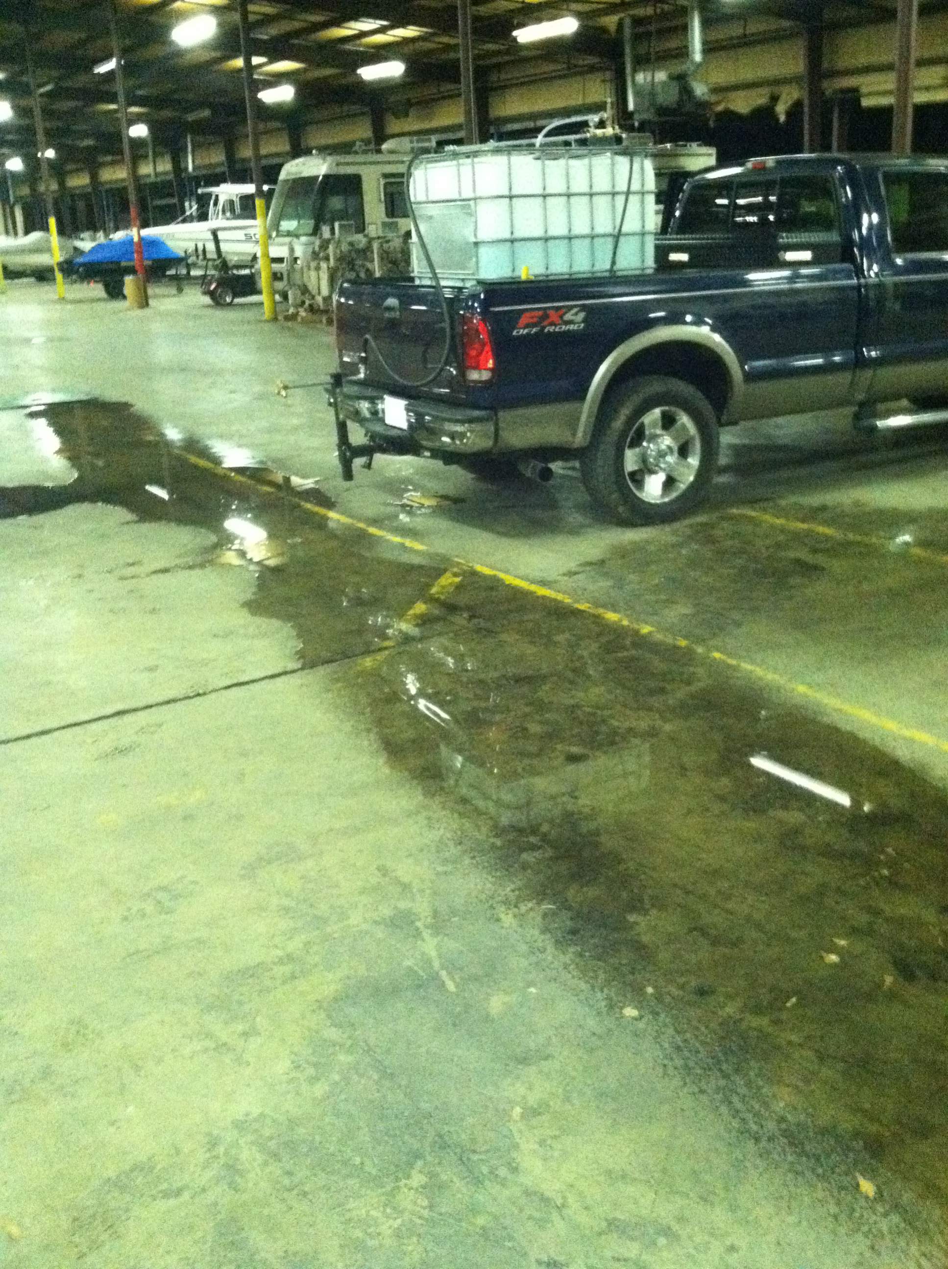

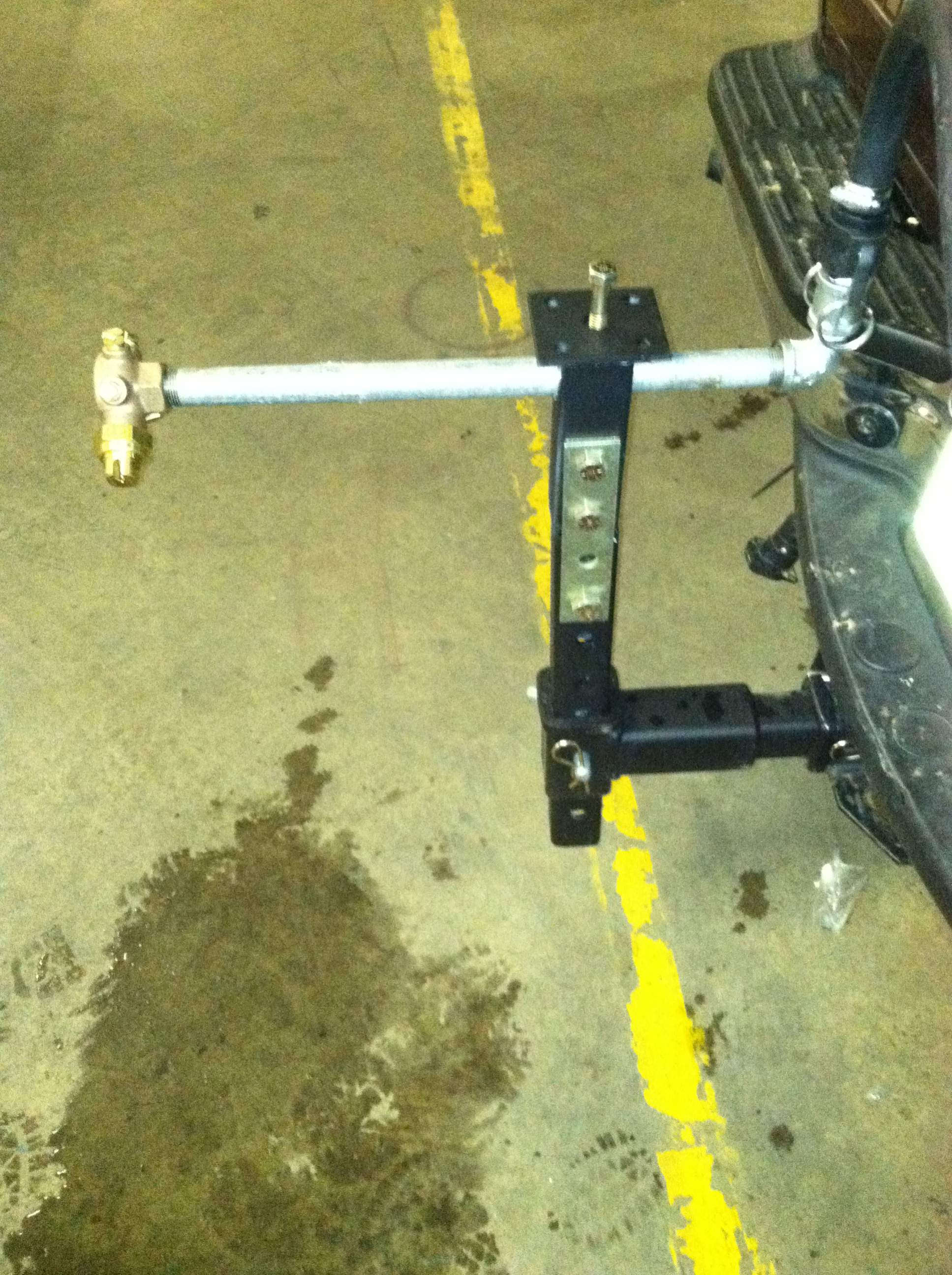

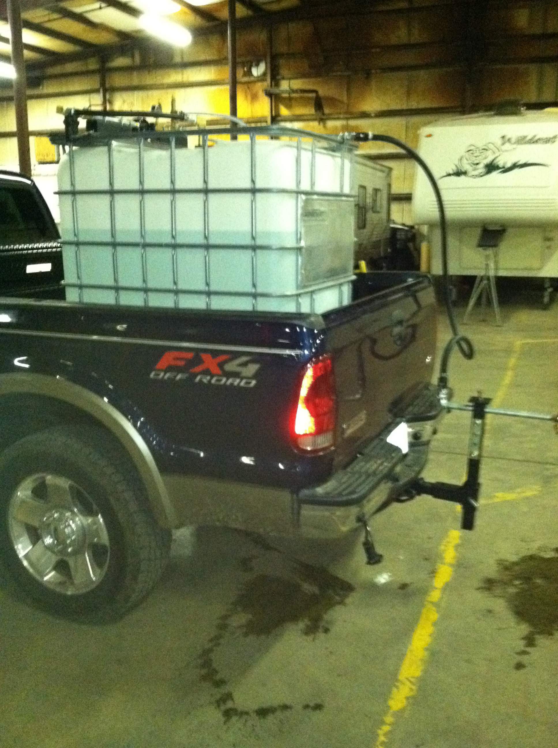

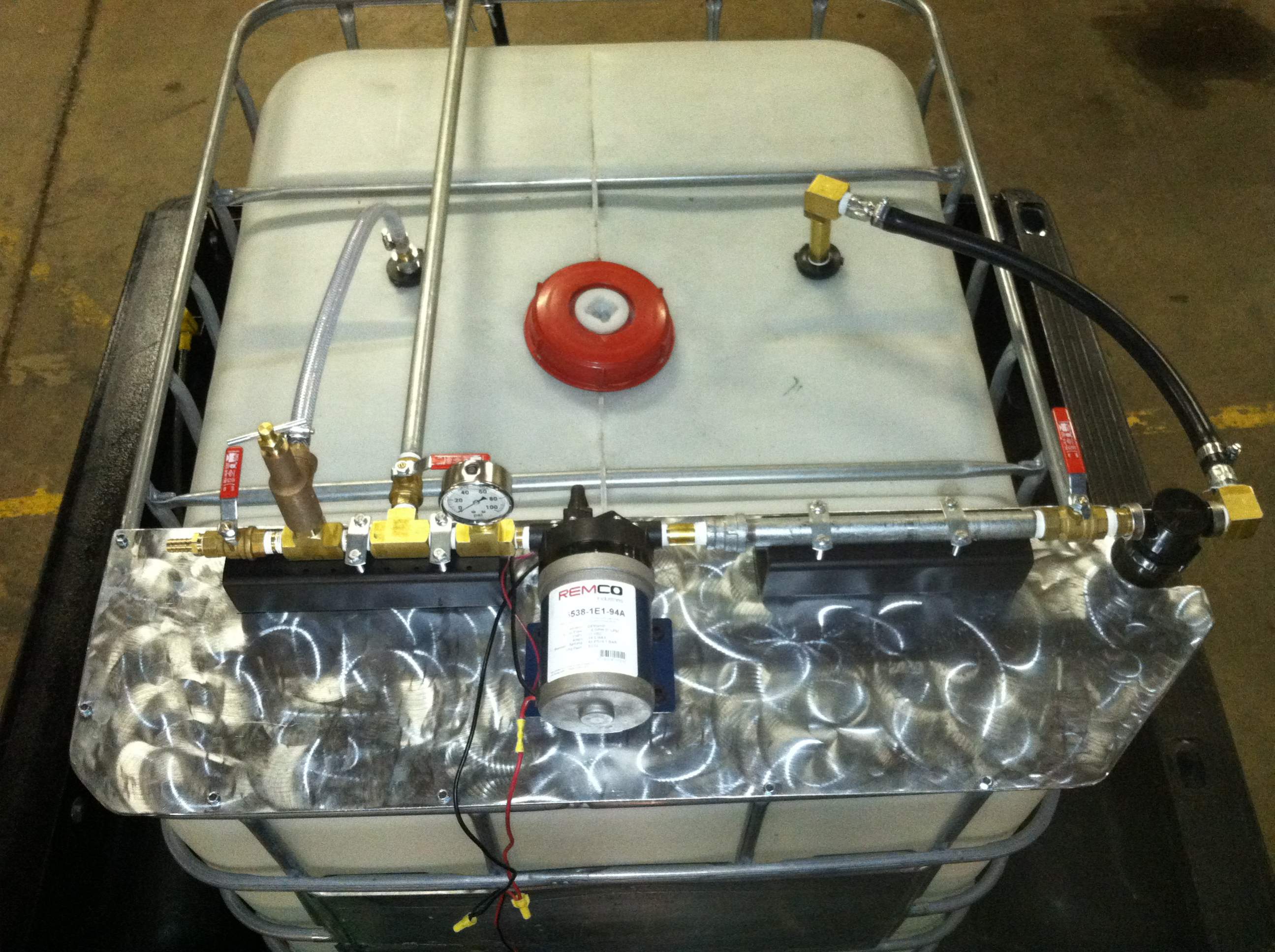

planter in use 115.jpg046.jpg052.jpg057.jpglet me offer an alternative if you have some fabrication skills. I built a system for my truck using a 275 gallon tote (cost $50) I bought a good quality 12V pump and a high end boomless nozzle. All other parts were common Home Depot fittings and hoses. Total cost could be kept under $400. I load it in my truck, attach the fabricated boomless nozzle to my hitch, and run it off of a 12 V battery (although I plan to eventually hardwire a receptacle and switch it with one of my dash upfitter switches) Now I use one of the little keychain remote switches or just have a buddy ride in the back controlling the switch). I can dispense 200 gallons (10 acres worth) in less than an hour from the comfort of my truck. I spray all my roads and foodplots this way and my kill is very complete and coverage is excellent. I have the Fimco you mentioned also, but I get tired of refilling the tank so many times. I have seen no difference in coverage and kill with the two systems (the boom on my Fimco vs. the boomless on my truck) Dead is dead!
