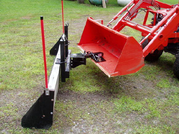

Has anyone ever mounted a snowblade to a front loader? I was looking at my rear blade and it seems possible with a couple of holes drilled in the bucket. Id really like the snow plow up front where it belongs, much more efficient. Brad
   / Mount snowblade on FEL? #2
a 3PH blade does not have the spring loads necessary for the front in case the blade comes in contact with some "immovable" object.
You can buy blades made to mount to your loader arms, set up like a truck blade, from Curtis and others or there are a couple of other alternatives...

Curtis doesn't make them for all tractors, but only some models. They don't make one for the BX series Kubota tractors.
   / Mount snowblade on FEL? #4
Even the lightest blade Curtis makes would be too much for the BX series. It's a handful for my 2410 (hence the new setup in the pic).

Thats a really interesting configuration your using Semour, is it homemade or storebought? Brad
   / Mount snowblade on FEL? #7
Brad
SeymourBota mounted his blade on a B2410. The blade he has mounted on his FEL may be too heavy for a BX.
Here is a link to his original thread on the project. Click Here
There are many blades on EBAY that could be adapted to your BX FEL.
