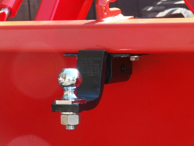

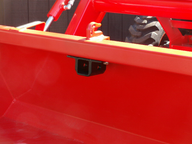

Many good ideas out there to pick from.
What I did,

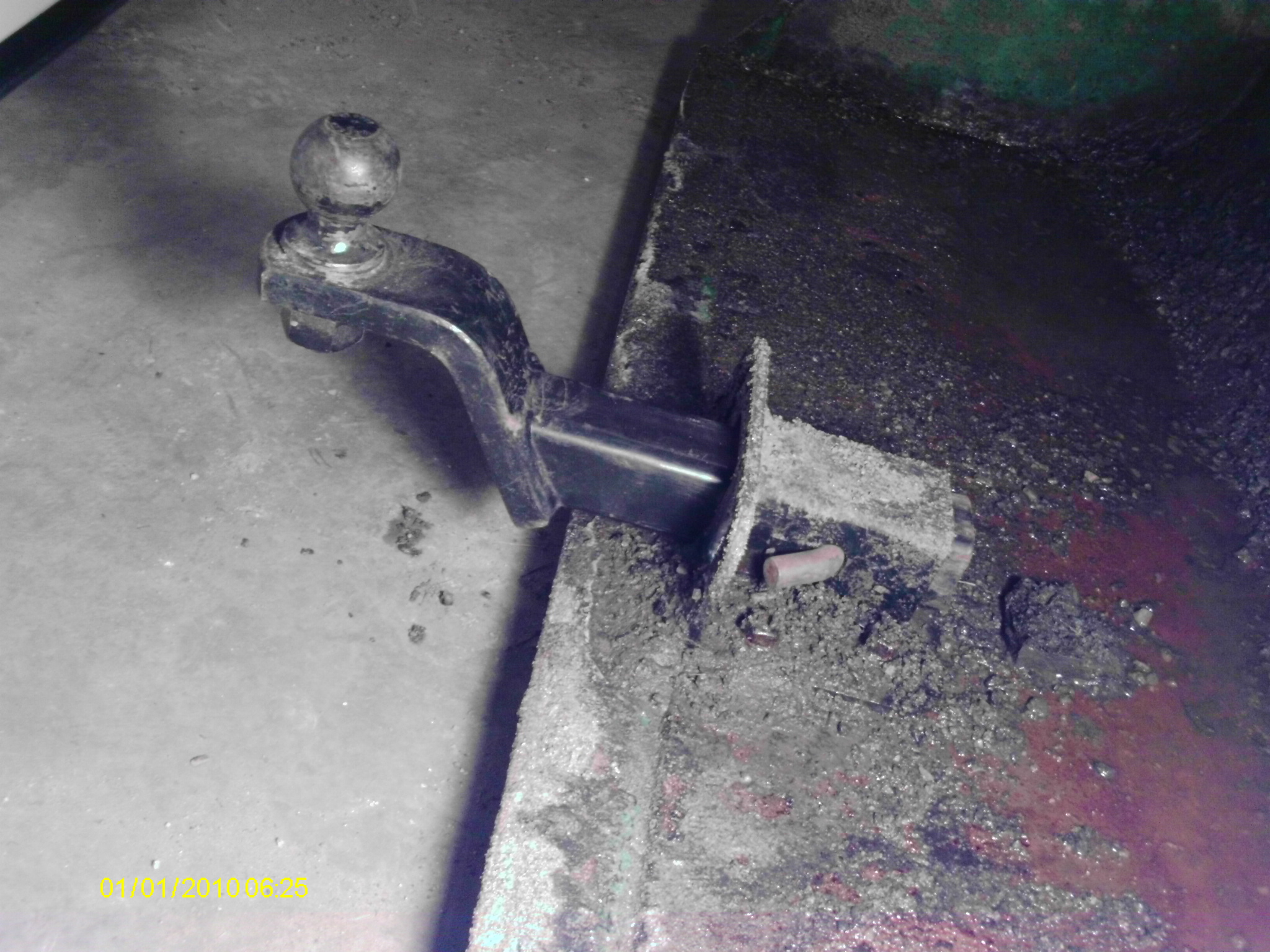

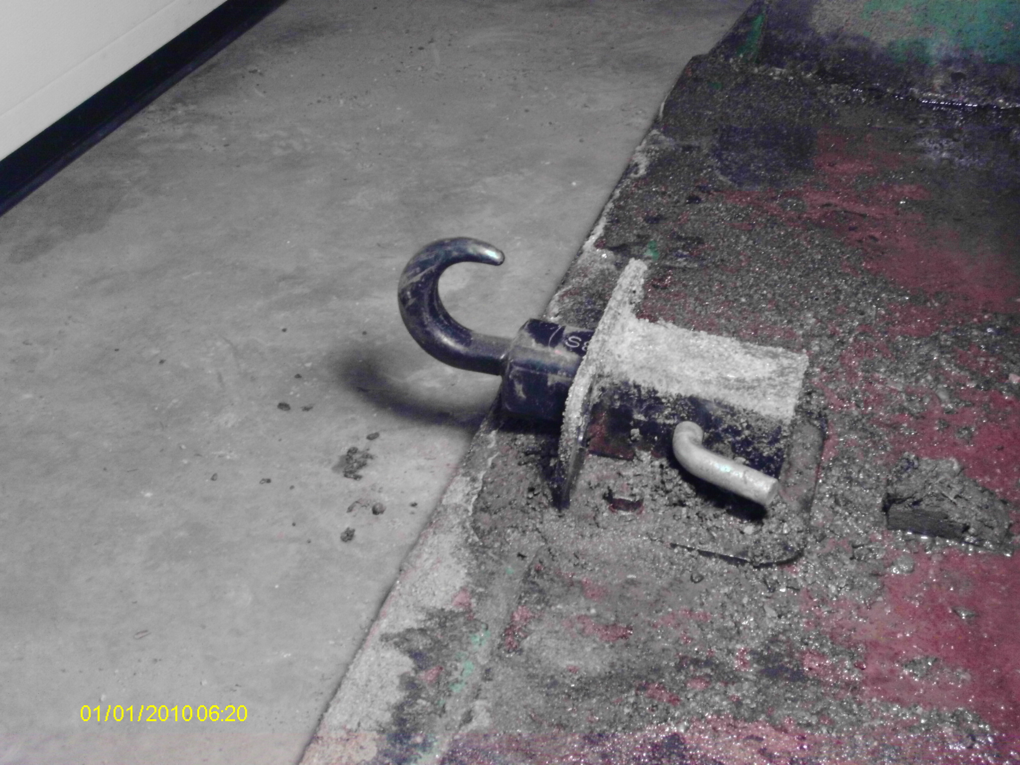

Years ago I bolted down an old step bumper 2 inch receiver to my bucket for such purposes...do they even make that style anymore?
