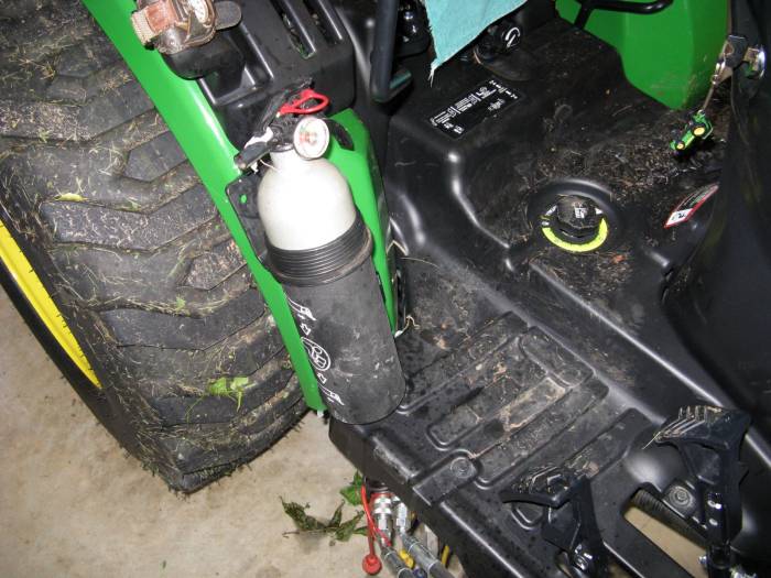

I have mine mounted inside one of those paperwork containers that Frontier gives us with every implement. The cut down container is bolted to the front of my right fender on the 2025R.
Ralph

I'm concerned that if you do need an extinguisher, a very small one might not be big enough. A welding operation recently caught a tractor on fire, then burned through the plastic gravity fed fuel line.
Or an electrical fire where there is a lot of stored energy in the battery until it is expended or a conductor burns through. That can take time.
Often extinguishers are deployed in the wrong spot or can't access the fire proper.
