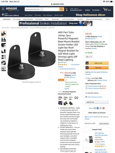

   / Mounting Auxiliary Lights #7
This is what I used to mount my light bar to the ROPS;
Amazon
AKD Part Tube clamp, 2pcs Powerful Magnetic Base Mount Bracket Sucker Holder LED Light Bar Roof Magnet Bracket for LED Work Light Driving Lights Off Road Lighting IMG_0058.JPG

   / Mounting Auxiliary Lights #9
Those are exactly what i bought to mount my lights. Just need to do it before the snow gets here.
I rarely lift my rops due to garage height, and with the magnets, i can turn them backwards when using my rear blade, which is what i use to clear my driveway.
