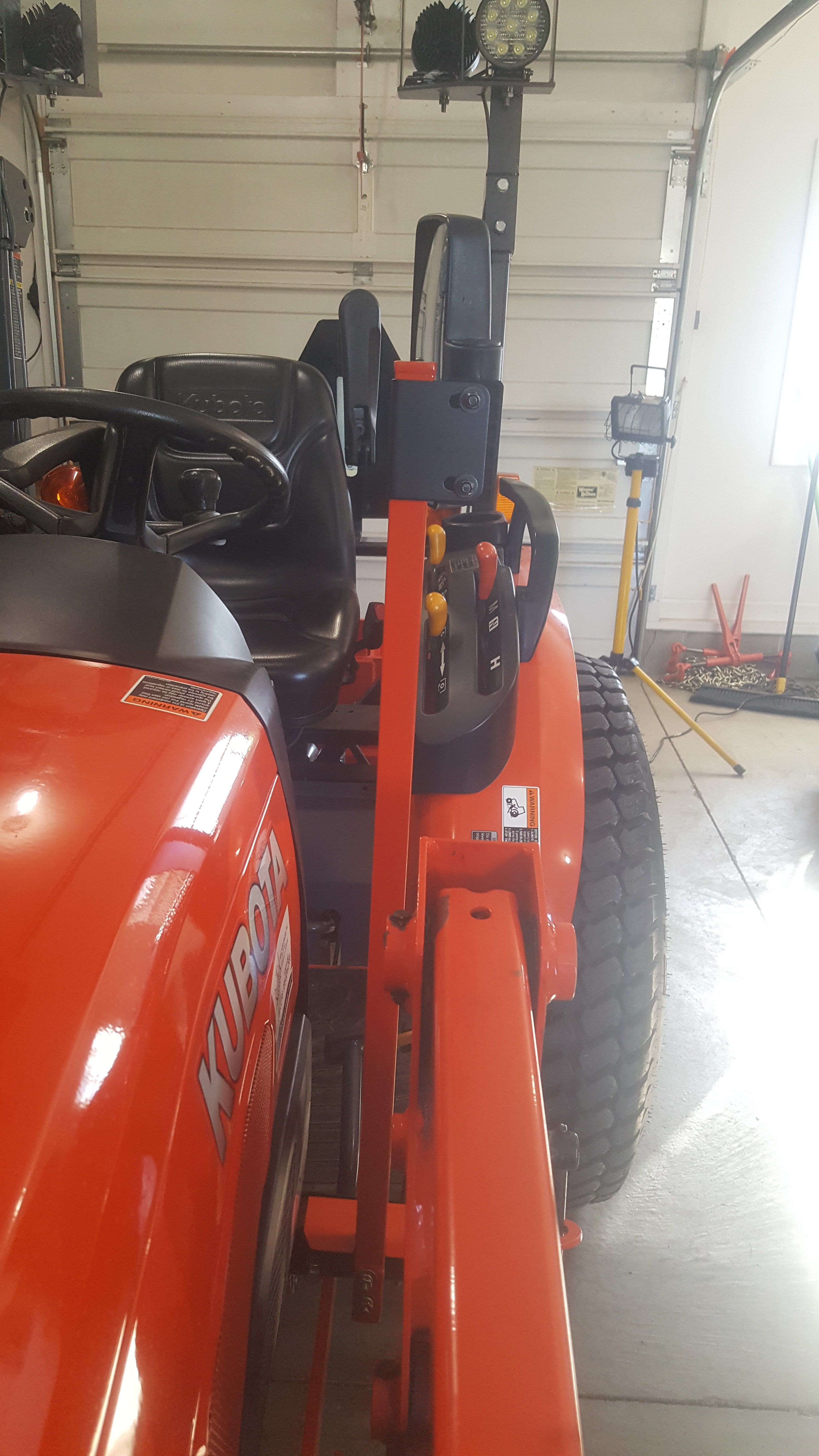

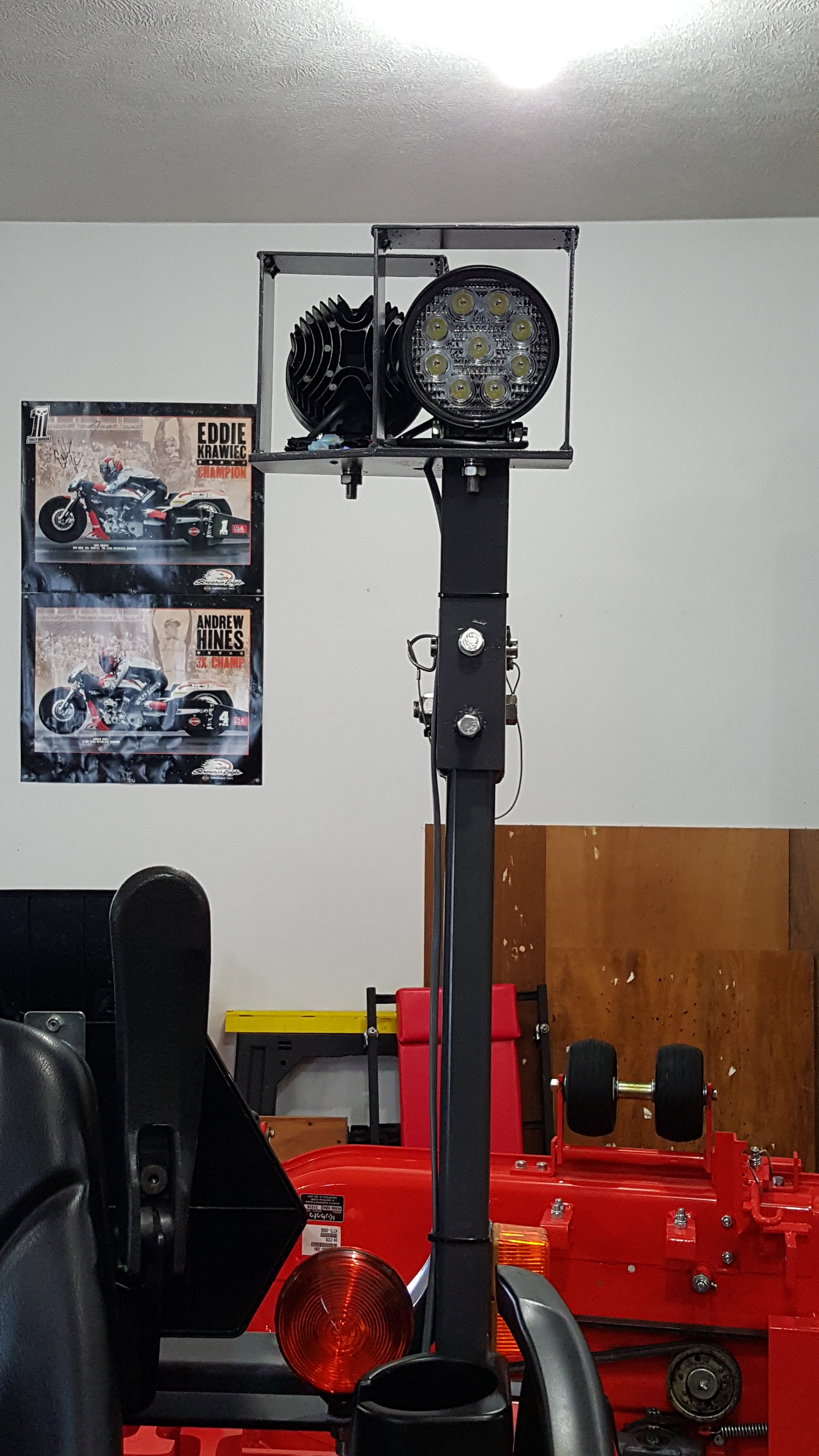

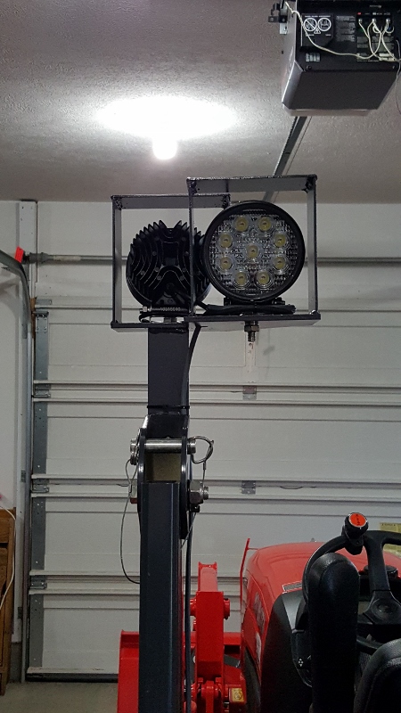

I had the same problelm on my B2650. Cant have my rops up and get in the garage. I fabbed up these mounts to keep them up high and just get in my door. Has worked out very well.20180326_094538.jpg20151215_101203 (450x800).jpg20151215_101616.jpg

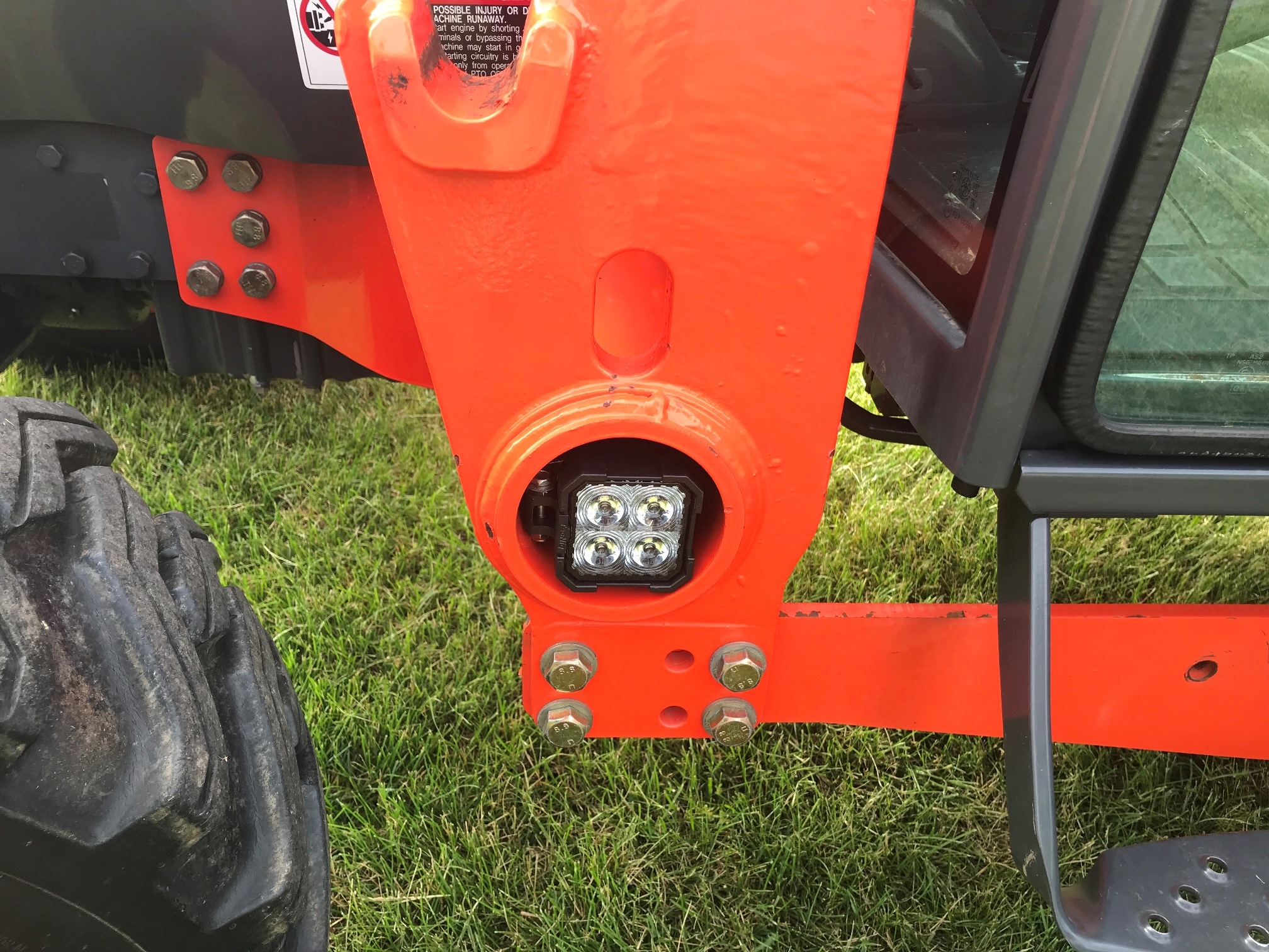

Two at cab top front, two rear, two low in grille and two cubes in the loader support tubes. Good to operate 24/7. With the cab the bugs don't matter. I have had open station tractors and ROPS mounted lights were awful, between the bugs and the glare. I normally mow without the forward facing cab mounted lights. They make the hood too bright. The low grille mounted lights work very well by themselves.

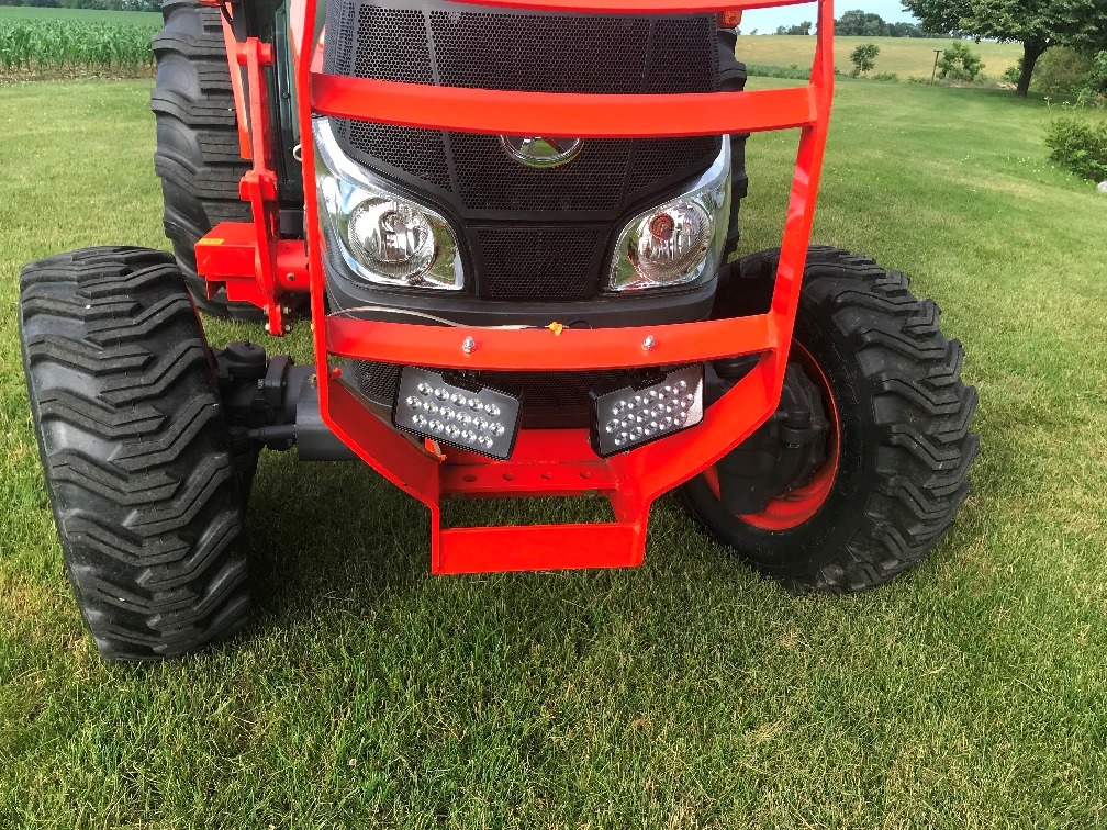

I mounted a ..?..12” LED light bar on the front brush guard of my L3450…an oldie. I used 3” magnets as I didn’t want to drill holes. To solve the problem of wiring and a switch, I disconnected the low beam feed and spliced that to my LED bar. If I ever want to go back to ‘stock’ all I have to do is ‘unplug and re connect’.
