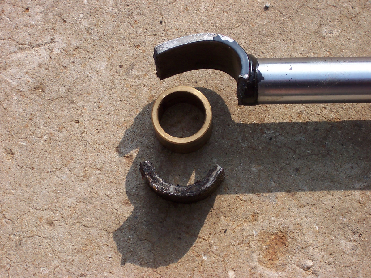

I got a great deal on a new Jinma Hoe on ebay and modified the sub frame to fit my Branson 3510.
It is a light duty Hoe but really does a good job if you remember that it IS light duty.
I have had a couple hoses blow apart and had to custom make some fittings to adapt common hoses to the cylinders. (It has some kind of Chi fitting that my local Hyd Shop could not match up)
I also had a cylinder end break and had to repair that.
I made a 6" bucket for it for trenching (I replaced my septic drain field lines) and it is really handy for a lot of things.
I made a seat mount that fits the top hole of the top link and I just put a pin in the hole (my tractor has 3 holes). I use the bottom hole for the Hoe.
I made mounts for the subframe to fit where my 3pt arms attach to the axle. The original S F is only 2" X 3" box tubing.
On the front of the S F I made "J" bolts (used upside down) that just hook to the FEL S F. With S F mounted to the rear axle the only front motion will be up and down.
I am also using my tractor hydraulics even though I got the pump and tank. It was a lot easier to do it that way.
If you have any questions I will try to answer them.
