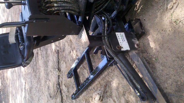

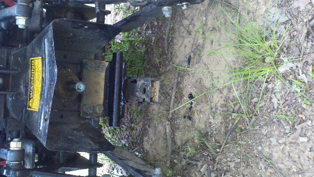

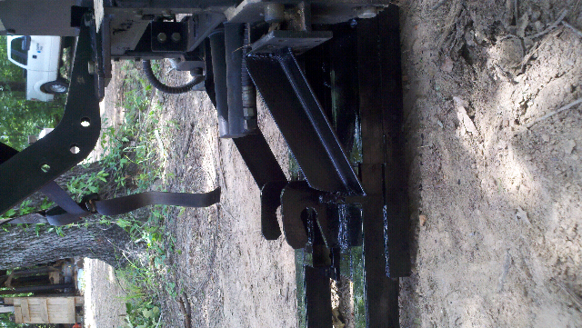

#27
Here are a few pictures of the subframe I built. I put a coat of paint on it and snapped some pictures. There's one picture of the drawbar with a 7.5 inch long piece of cold roll welded to it. The two ears on the back of the subframe slip over the cold roll. Then I can pick the backhoe boom up and it is pinned to two half inch plates I welded to the front end loader crossmember. This is the same concept Mahindra uses to mount a backhoe on the 2516. I also made a short toplink for a little extra insurance. I don't have to remove the 3 point arms to attach it. I do have to disconnect the lift arms from the 3 point arms and they lay on top of the outriggers. I have removed 2 pine stumps, an oak stump, and 3 small sweetgum stumps so far and had no trouble other than a small hydraulic leak which is now fixed.
