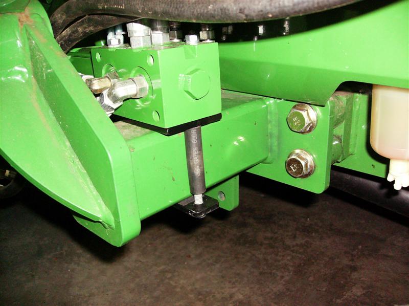

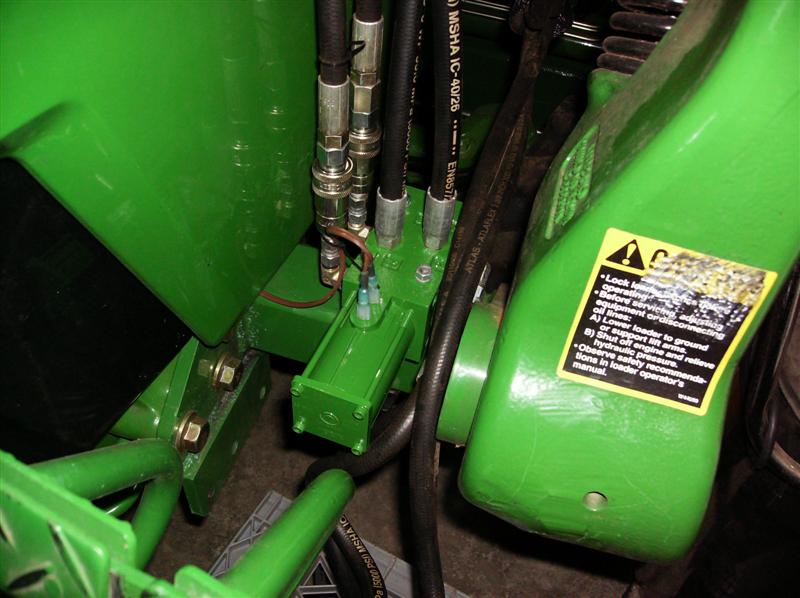

Just looking for ideas for mounting new hydraulics. Got the main components (not the fittings and hoses yet) and looking to mount it. Not seeing anywhere nice on my kubota b2400. This is for a solenoid and baseplate for the grapple. I'll (later) be adding rear hydraulics but I don't see any problems for mounting that... yet. Not ready to buy those components even...

Don't know what valve you have, but here's where I mounted mine on my Deere.
