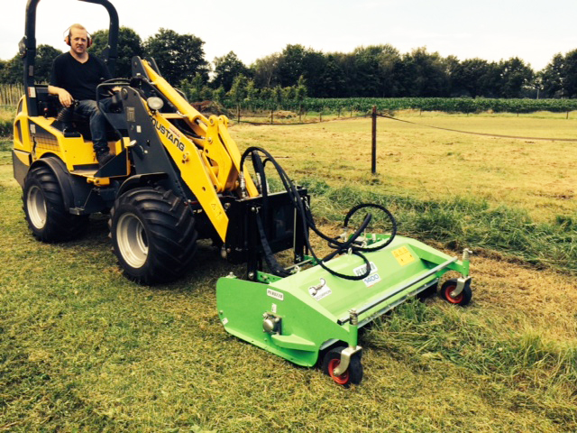

Great information everyone. Thanks. It looks like I will need to do a bit of hunting and modification to end up with a from mounted flail mower I can afford. I did get a quote from Iowa Farm Equipment for this slick Italian (Peruzzo) flail mower with a hydraulic motor spec'd for my 425 for a measly 4 grand plus shipping
As much as it would be great to have something new and perfect I think it's going to end up being used and "we'll make it work"
Aaron Z, Thanks for the link to the 40" Vemco flail mower for sale ($400) in Bend. I just called the seller and he said he might be willing to deliver it as his wife likes visiting the Coast. Titan Attachments has a sale on a brand new 48" pull behind flail mower with free shipping for $1,080 so that might be well worth it. Though it looks like the3 Vemvo might be a little easier to convert.
