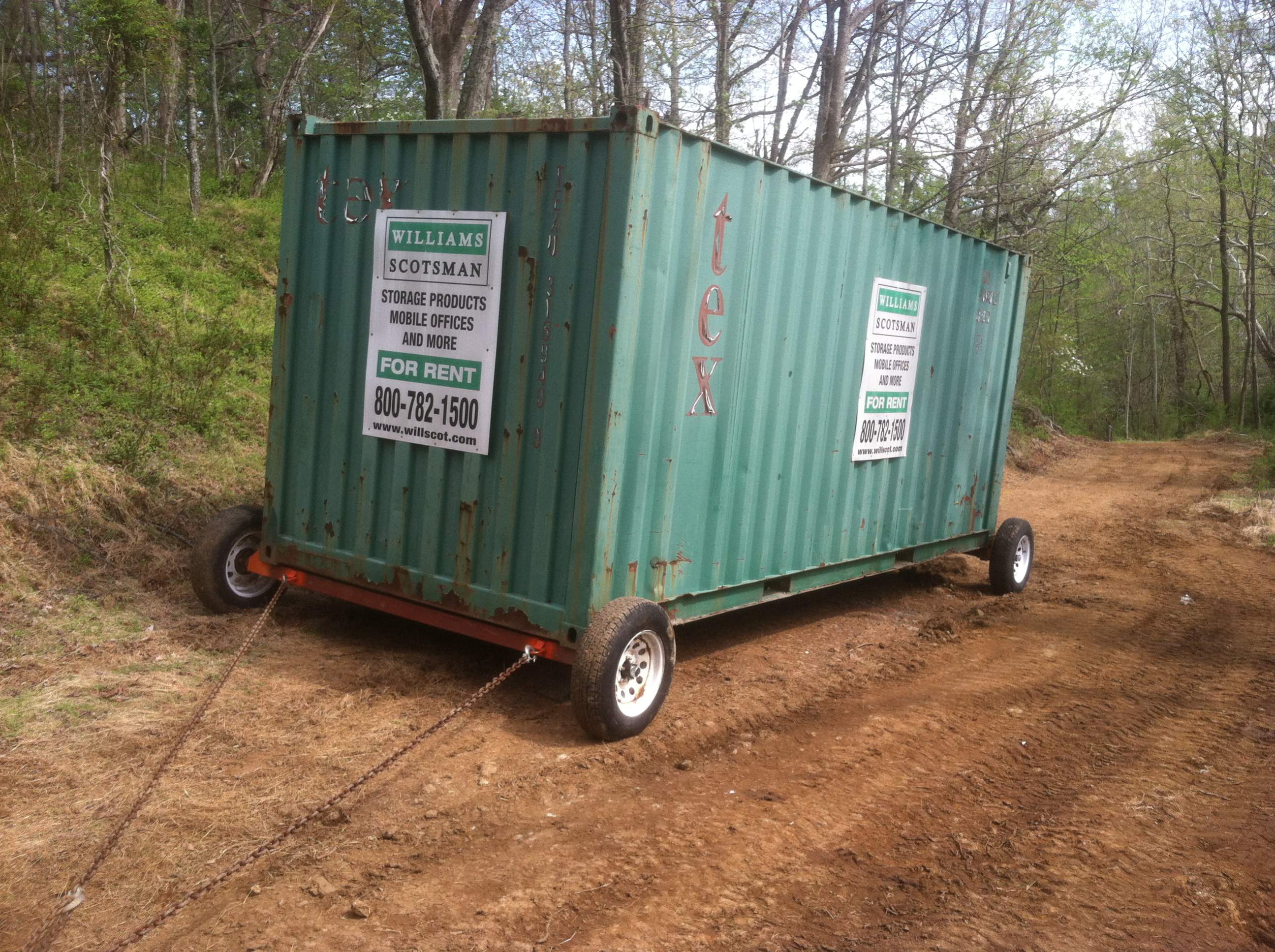

I pulled this shipping container 200' up a 20* slope.
But I used a 500' cable and a 14k snatch block tied off to a really big poplar tree.
I hooked the cable to the shipping container, thru the snatch block and then to the draw bar on the tractor.
That way the tractor was going down hill pulling the cable.
I know that you need to hitch the trailer tongue to something though.
But you could put some kind of safety leash on the front of the tractor to prevent a runaway situation.
Maybe a winch to a truck?

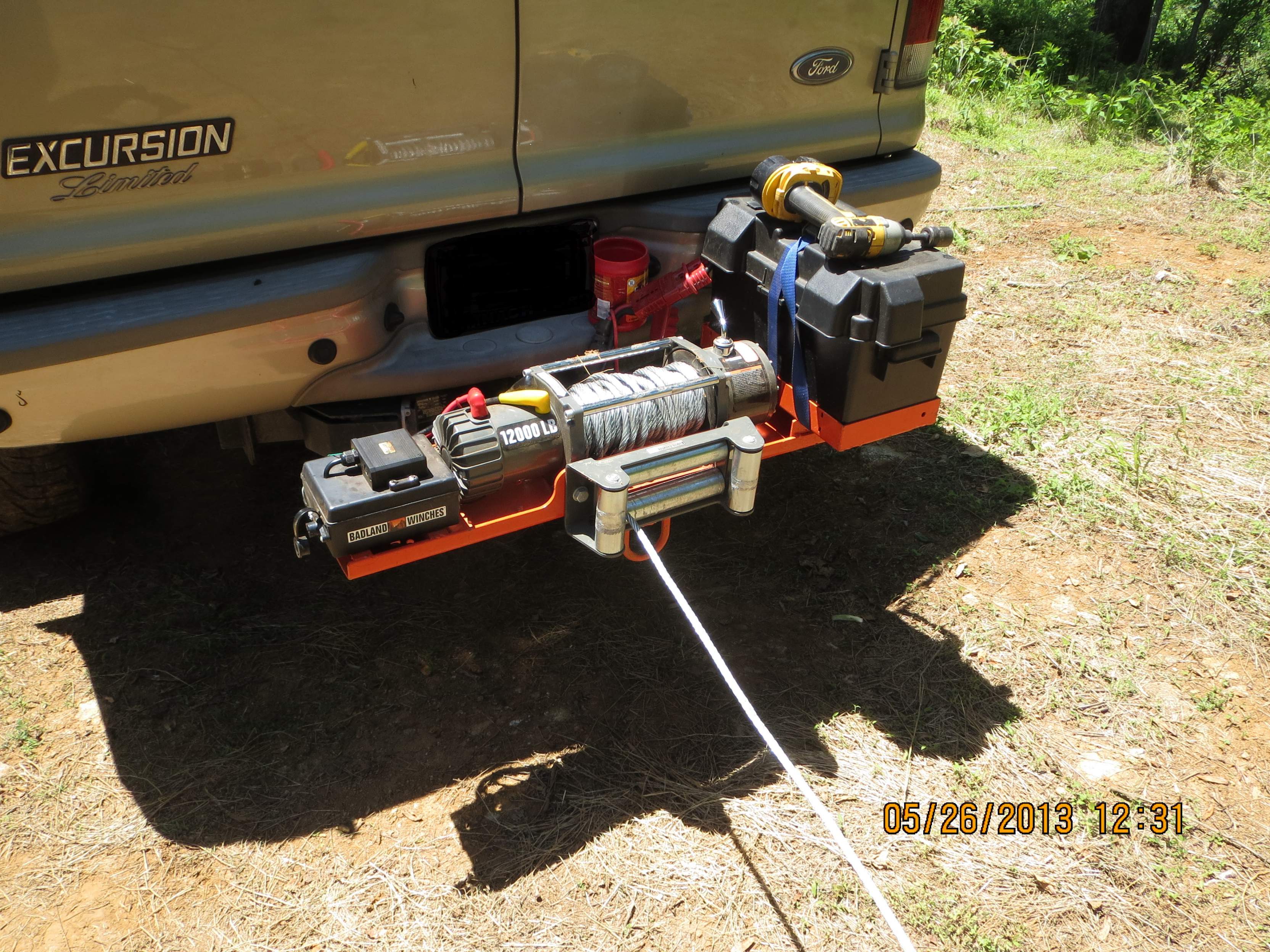

I have one of those Harbor Freight 12k With a wireless remote and I did use that as my safety leash.
Chain on shipping container to cable

HF Winch
