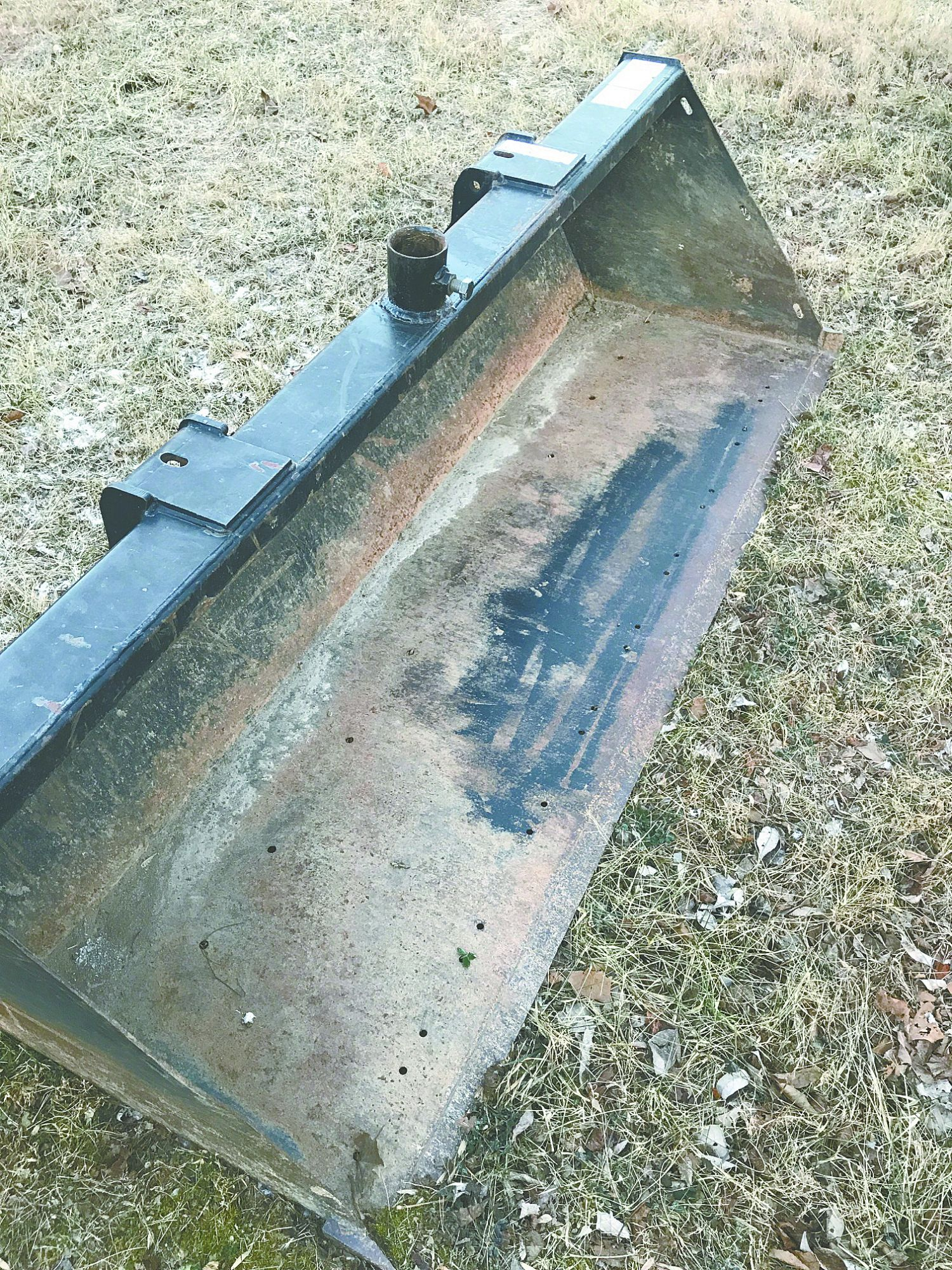

Sounds risky by weight. Flat ground helps. Maybe the pipe like pictured with an electrical connection to power to activate the trailer brakes.

I think pin weight is less than 1600. Bucket lift spec is 1800. I dont' want to buy a stupid adapter. I'm thinking I will wrap a 3/8 chain tight around the pin and box, then tie that to the bucket with a 30k web strap. Tires are liquid filled and the backhoe is 1200 including subframe. New Kioti CK2610. Backing it into a garage, no more than 100', smooth flat ground.
Anybody done this? Pics?
The tractor is to small for this job. You need about double that weight.
   / Moving 26' 5th wheel camper with a loader/backhoe #18
I like that idea. More secure. Make sure the weld holds.;)

I move my 25' 5th wheel with my GC2610TLB frequently and use some dollies on the wheels to be able to park it close to a wall for winter storage inside. I have some adapters I made with a "cup" near the top edge of the bucket similar to the picture in post #12. but without the locking bolt. My trailer has pin weight of about 800# and my loader will lift it. I'm on level ground so don't worry about brakes. A neighbour needed to move his 5th after building a residence and didn't leave enough room to get a pickup attached. His was a 30' model and my tractor wouldn't lift the front until two men stood on the rear bumper and I was able to move it to a position where the truck could attach,
