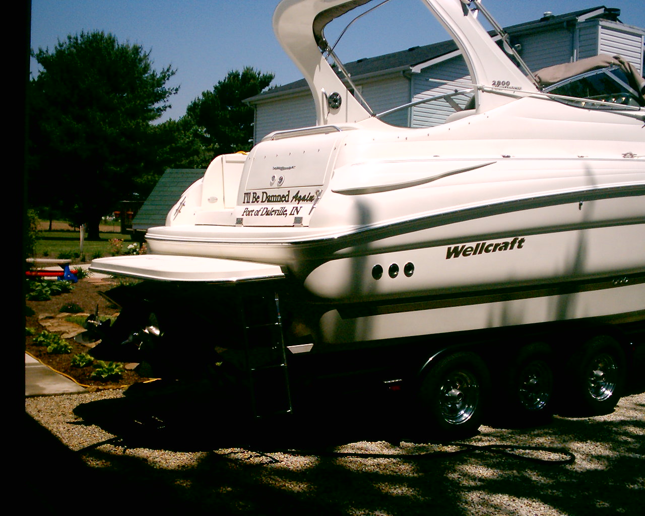

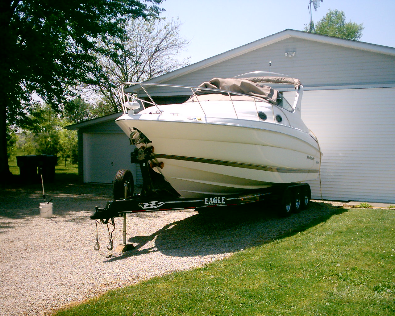

I will chime in here. Boat manufactures lie. Weight and HP = speed. The lighter a boat the faster it is with X HP. Most boats list the empty weight with the base motor or in the case of a outboard most list the weight with no motor. Case in point is this boat in my picture. According to the manufacture it weighs 9,500# but that is boat only, base single engine, no generator, stereo, tv/dvd, ect. The trailer weighs 2,800# so the total weight should have been around 12,500# ballpark. I had it weighed the day I bought it 15 minutes after the papers were signed and it weighed 15,600# with no water and 5 gallons of fuel. It does have twins, generator, AC/Heat, TV/DVD, and a heck of a stereo.
Either way you will have no issues with your truck but the tires are still my main concern. I am in the marine business and sell and tow about 75 boats a year. Tires are my biggest issues.
