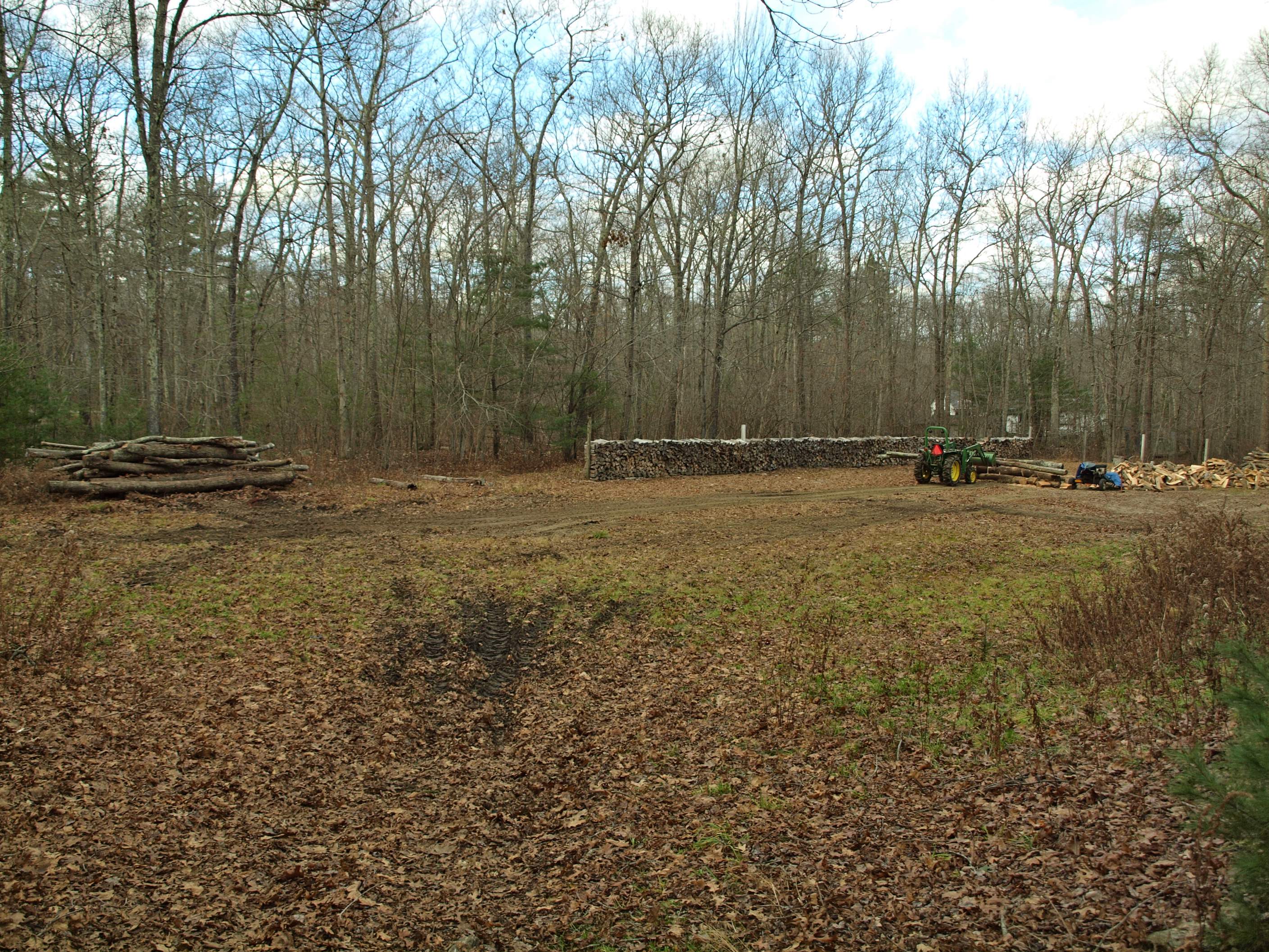

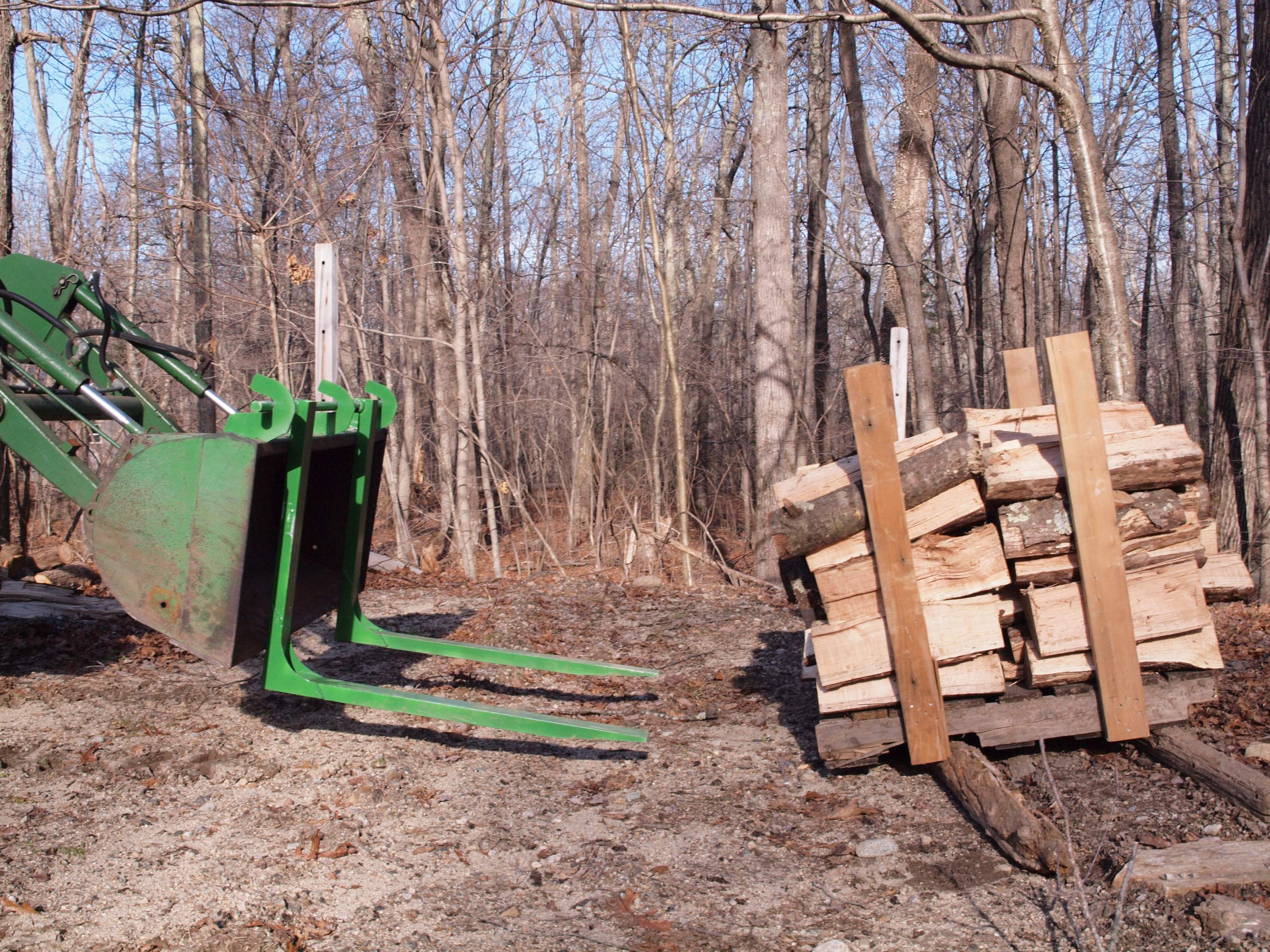

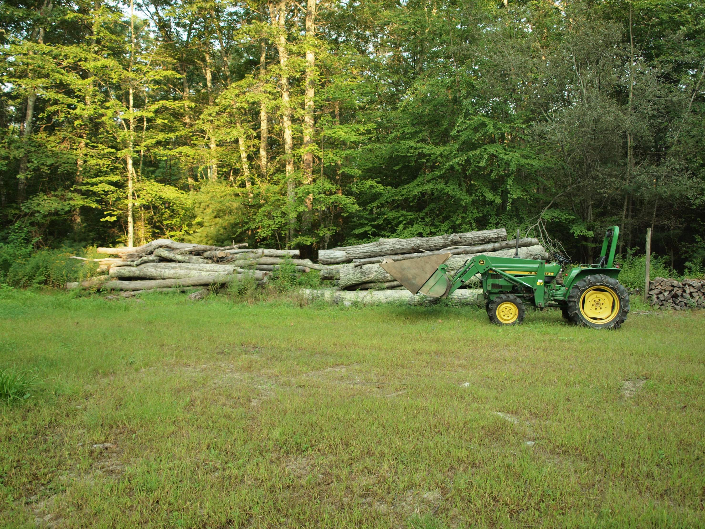

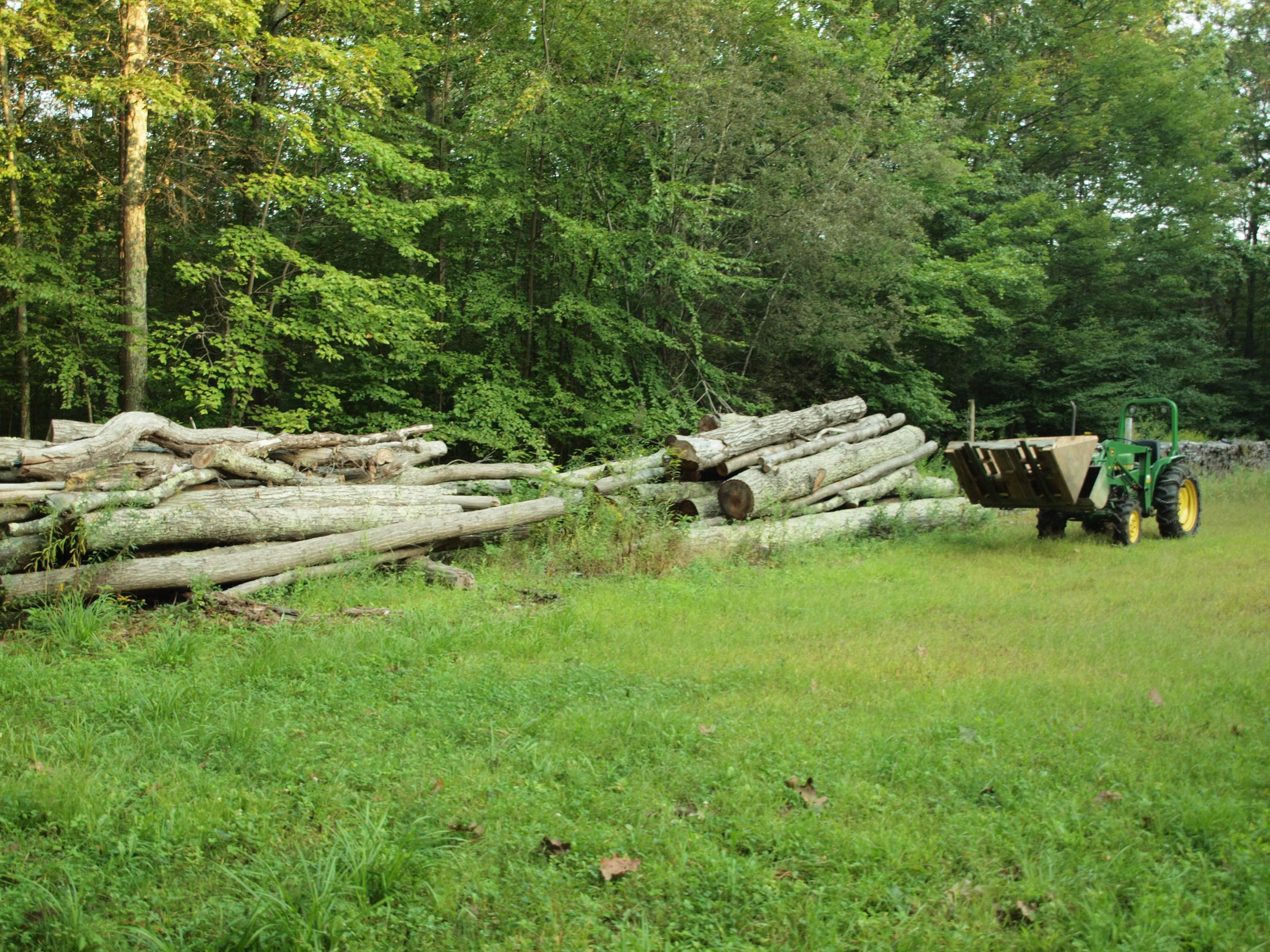

Roman, I built these for my bucket and probably cut my capacity almost in half. As my loader only had a bit over an 900Lb lift to start off with, this was not conducive to an efficient pallet method with this tractor. The loader struggled with this load of wet oak. This pallet measures 42" wide by 3' and is piled a bit less than 2 feet. This set up costs around $400 to buy (I made mine for about $125) and what its advantage is of the easy off nature of the forks. A dedicated fork set costs around $600 but will lift heavier loads. I have a pinned loader as opposed to quick attach so I appreciate the easy off nature. although I feel the pallet method is probably the most efficient way to handle firewood as least as possible, my current set up doesn't fit in to this as I would have to have around 30 pallets to move 5 or 6 full cord of firewood. As necessity is the mother of invention, I built this big "bucket extension" as my stacks are only one width thick, I just go in back of the stack and push the wood over into the bucket. This "wood bucket" is also slipped onto the forks making it easy to remove as well.Not perfect but better than loading it once more by hand.
