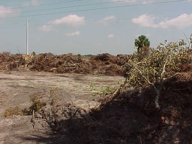

We selectively cleared 5 acres; took out all the trash (Brazilian Pepper trees and wild grape vines), leaving the native growth. There was a lot of trash. We ended up with 48 large piles of brush spaced throughout the property. Grape vines come up like a carpet and bring a lot of dirt with them; we weren't successful in burning. I thought about a chipper, but vines are tough to chip, especially when loaded with dirt.
So, since we were scheduled to get a large excavator to dig a pond, we decided to bury the trash growth in a remote corner of the property. All I had to do was move the piles.
Even with the large, rented Cat 416C with a root rake (picture attached), the only thing that worked was a rake full at a time. We tried pushing it. We tried pulling it. We tried piling it on a flat bed trailer; that worked, except it was harder to unload than moving it a little at a time.
I spent 6 days or so on the big tractor, snatching a rake full of brush, then traveling distances up to 700 feet to dump it. Load after load; until I finally had a "pile" about 10' high, 20' to 30' wide, and 200' long (picture in the next post).
Now, I have a better way -- I bought a 6' x 12' dump trailer which I can unhook, fill, then hook up again and pull with the tractor. But, it was too late for one of the dirtiest jobs I've ever done. Sorry I don't have any magic bullets or good news; the only good news is all the seat time you're going to get.

Part of the resulting pile.

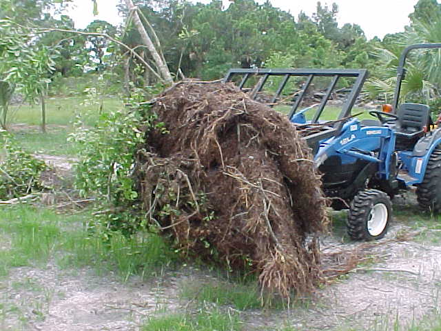

I also built a bucket-mounted root rake for my little TC18, and, while it wouldn't hold as much as the big Cat, we made almost as many trips with it.

A toothbar on the bucket makes it about 1000x easier to pick up brush.
I would want a 4 wheeled trailer to dump it in (preferably a dump trailer). 4 wheeled so you can unhook it from the tractor and then hook it back up after it's full.
Even if you had to unload it by hand it wouldn't be the end of life. It's easier to unload than to load.
