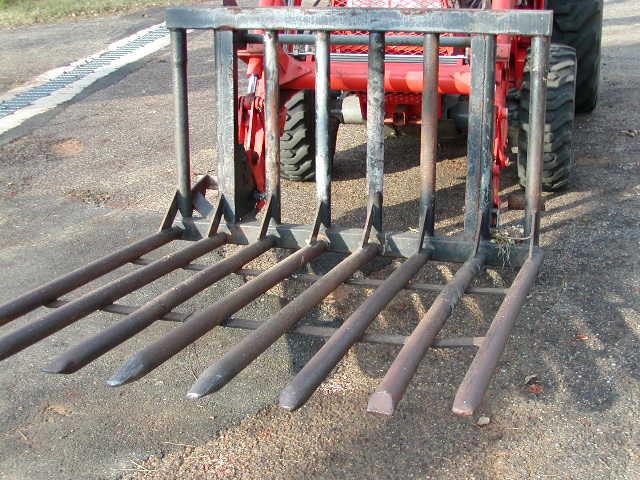

Attached is a set of forks I made to use.

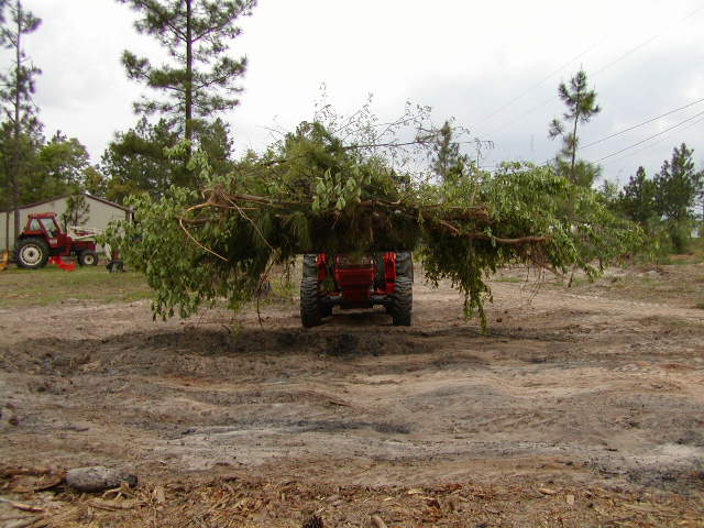

This is a small clearing in the woods, I make a large pile. When it is raining & I expect it to rain all day, I light the pile & burn it.
One load on the forks.

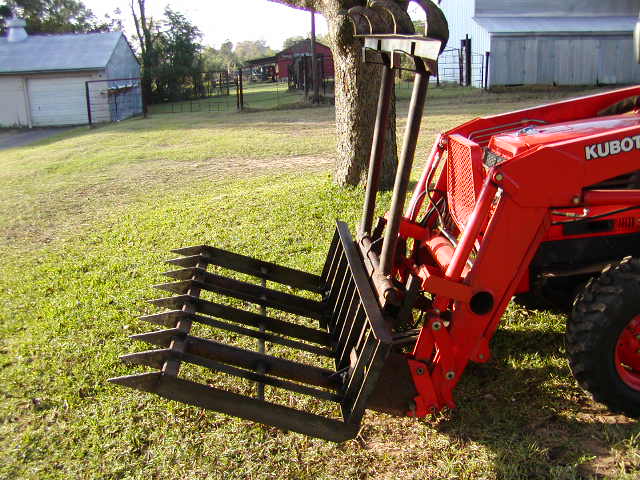

This is a different set of forks I built with a grapple.
I built this set later (shorter so could unload in dump truck easier).
There are other brush grapples on tbn that appear to me would work even better.
