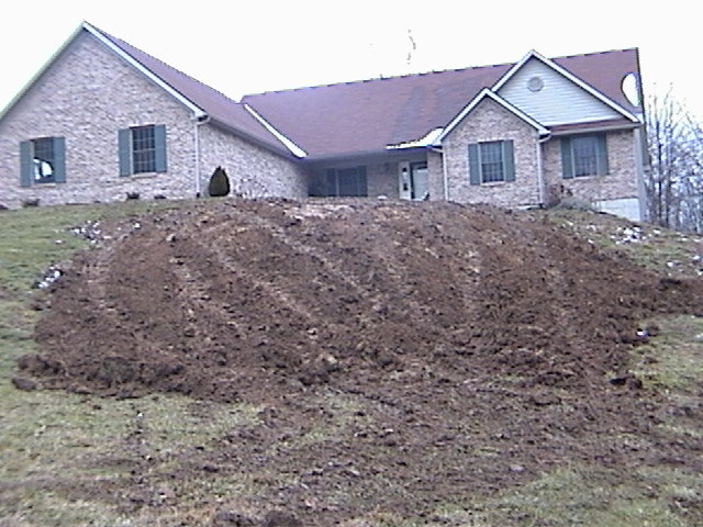

#18
Thanks Frank /w3tcompact/icons/smile.gif
The dirt pile is gone, but I will scrape up more.
RedDog

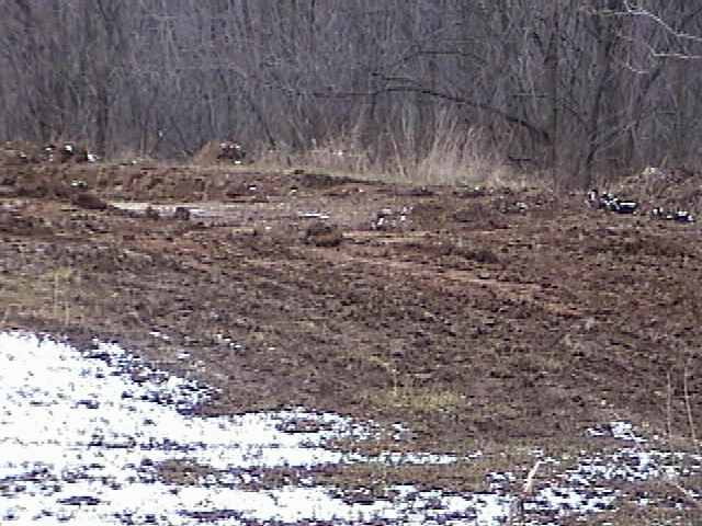

#19
The front yard now. It is better, but still needs more, and I have plenty more to go. /w3tcompact/icons/smile.gif
RedDog
/ Moving Dirt
#20
Another view of front yard.
RedDog
