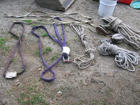

What would happen if the trres were wrapped in a thick layer of burlap...then a layer of 2x4's lashed around them for protection and then a rope attached to the "near" top with a small 4 part block with 3/8 cotton rope and then anchored to the butt of a fellow tree with a heavy strap for lowering to the ground with possibly 2 side ropes to control side swing and then the butts carefully dug and then drag the trees whole....on the ground flat to where ever u want them..and then pulled or pushed or both... up on trailer using a few heavy planks ( probably 6- 8 footers min) Your cut does not necessarily have to handle the whole load...personally i think that it would be very simple this way and would love to help!!! Always more than one way to skin a cat.. /forums/images/graemlins/grin.gif
