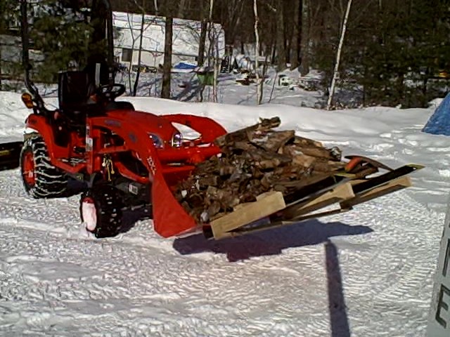

Scooby,
I had also thought of doing this with my BX. I think, due to the set up of the forks, the pallets need to be modified a little. If the clearance on the bottom of the pallets were doubled, the forks could get under them easier. In this pic I added a half pallet to the forks to expand what the bucket could carry.

Scooby- I move firewood all yeear around with my BX. I have loaded all kinds of wood in the bucket from pine,popular,maple,elm,hickory,ash with BX. I have used both FEL and rear firewood carrier I made. I find I can carry 4widex6high one row in my carrier better on my 3pt then in my FEL which is probably overloaded at 4x3 one row worth. I really don't care the tippy feeling with that much wood in the FEL when I need to transverse a hill. Having that much in the FEL is just unstable and I even added homemade forks and it can carry more in a stable way but I am finding that I have the rely on my traction on front wheels all the time and its no fun over bumps even with weight in the back unless I have my 3pt wood carrier on. Its much quicker for me to use my quick hitch to drop the firewood carrier in place then mess with forks on FEL.
IMHO, to move a pallet of firewood on a daily basis is way too much on a BX.
