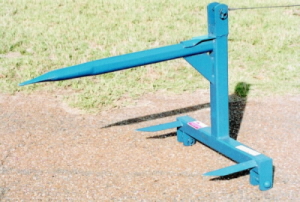

You need a loader up front, that is a given!!
Priefert 3 point Bale Spike

With the rear attachment you won't be able to lift them up and drop them in the ring feeder.
