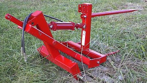

Re: Moving large round bales 6\' x 4\'
With this spear, you could more than likely get it in the ring. At least it gets high enough. You would need to be careful, when you had it up high.
   / Moving large round bales 6' x 4' #17
6 x 4 bales are a bit much stability wise for a 2wd 40 HP tractor. You will need a 4 wd 40-60HP tractor to be safe. A FEL would be nice. If you need to move these larger bales with a compact tractor then use a Tumble bug, pictured.
