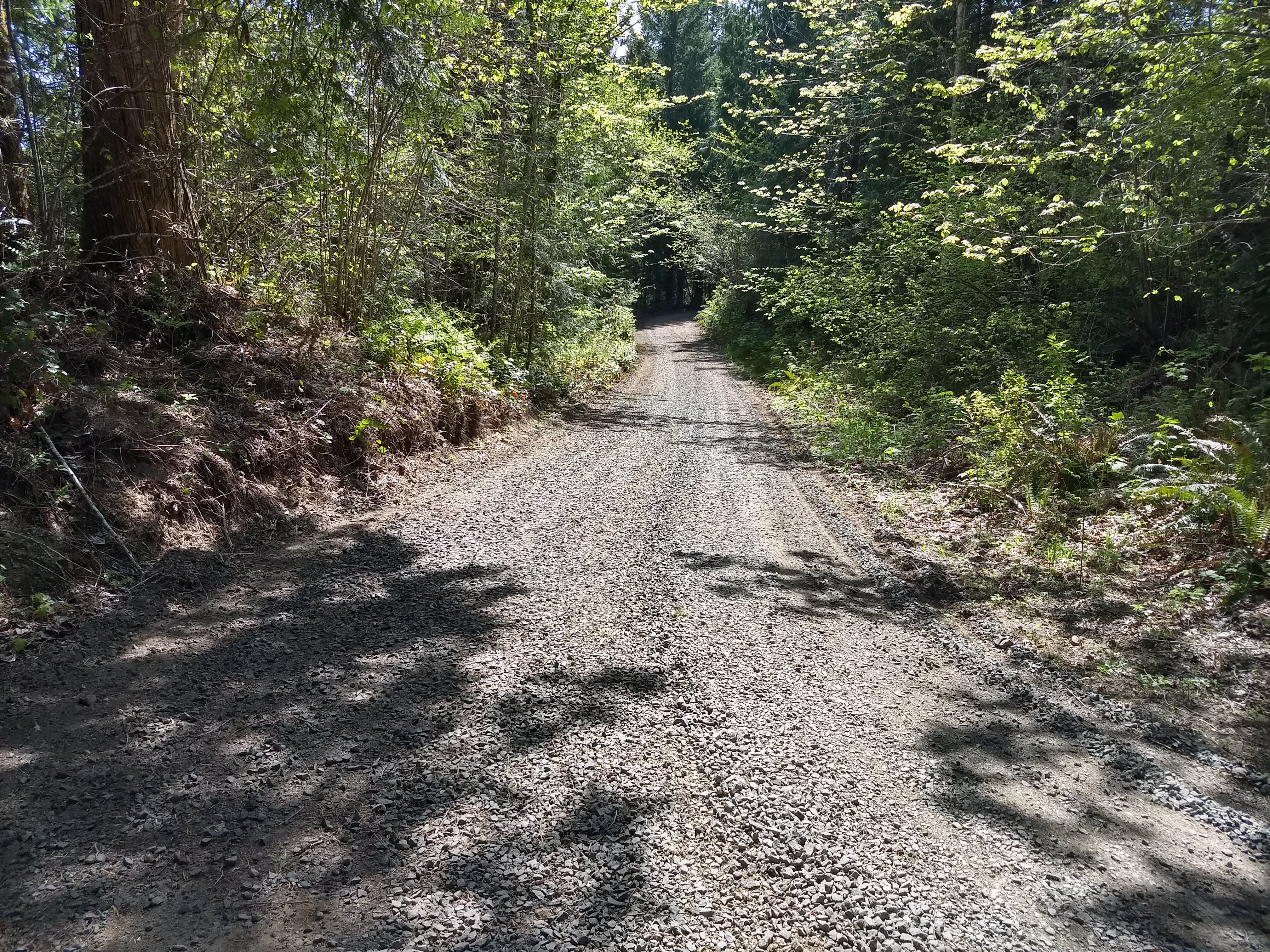

When I started using my landscape rake on my road I was very impressed. Got rid of my back blade and the box cutter.
The road started to show immediate results.
I wait till after a good two (ish) day rain spell and run the rake over the road. The biggest benifit of the rake is when I pull it very slow. It doesnt seperate the gravel from the dirt. This is my 3rd year using it and the road has never looked better.

Nice! I need a landscape rake sooo bad. I’ve been on the fence about just selling the box blade. I found an adjustable angle grader blade on Facebook for $200. I was able to get the sides scraped more efficiently thank God! It’s also a lot easier to hook up by myself too.
