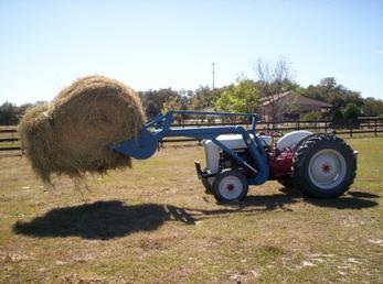

Do you have or have access to a utility trailer with ramps? Roll the bales on to the trailer and take them where you need them.
   / Moving round bales without a spear?? #12
strap it into your bucket...
here's my 1955 ford 850 with a single arm loader and a large 1000# tifton bale and a ratchet strap holding it all together.

I just don't think a L2800 is going to lift a round bale, with any size, with the loader. A wide strap might cost as much as a 3pt spear.

Remove FEL bucket (no need to lift extra weight)
snake chain thru FEL forward round brace "pipe", need several feet hanging out each end
drive metal pipe deep into/thru center of bale so it sticks out some on each end
attach chain to pipe, lift If FEL has enough capacity to do so, counterweight on rear!
haven't tried this with hay since I have a spear but have lifted heavy stuff by dropping FEL bucket and chaining to loader arm brace.

A lot of time and work to save a little bit of money.

I moved a round bale in my horse trailer, rolled it up the ramp with my bucket. I rolled it into the barn at other end. They roll pretty good, you don't say how far you have to go.
   / Moving round bales without a spear?? #20
I also suggest using a ratchet strap to hold it in the bucket. My dad and I have used this method to move round bales using his old B8200, which is a lot less tractor than yours.
