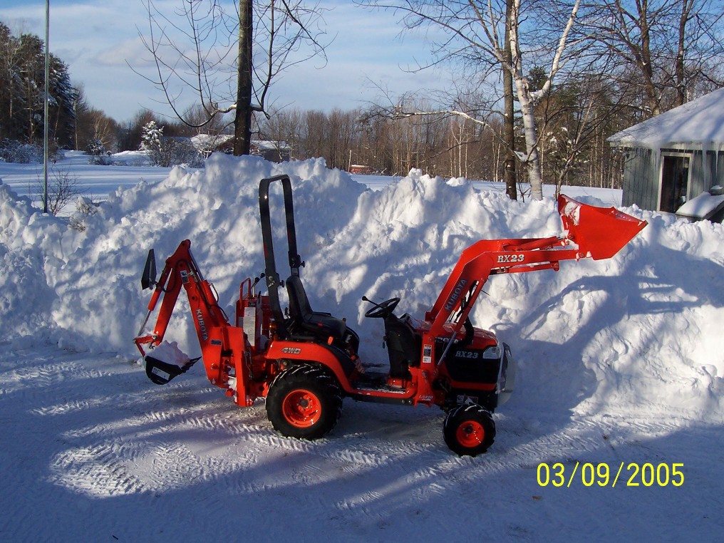

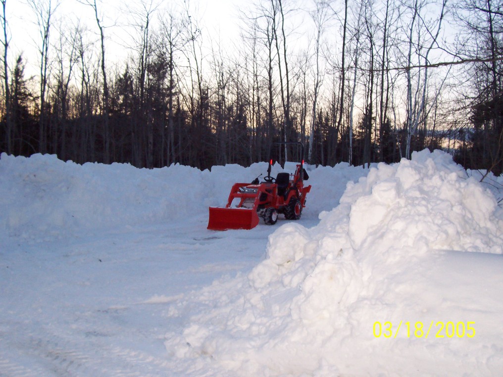

2 FEET HANDLES IT EASILY with loaded ag tires ,rear weight[hoe here] 4 wd and differential locked in

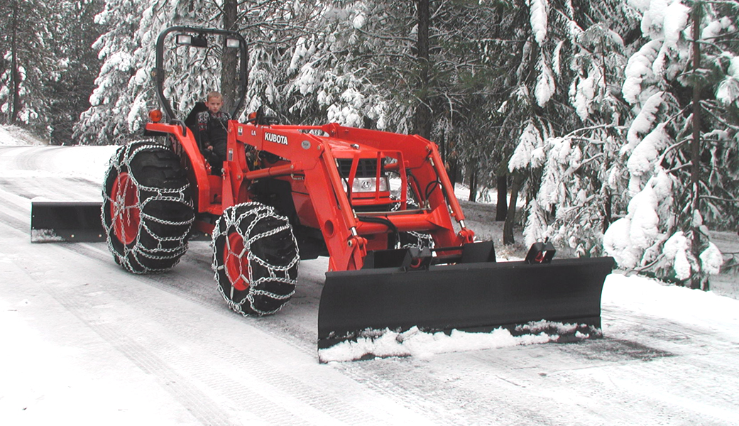

I think that NY_Yankees_Fan hit the nail on the head. You can certainly move snow with the FEL bucket, but it really comes down to how much time you have to spend clearing out the snow. I live on a mountain that gets significant snowfall over the winter, my drive is over a mile long to the county road, and several of the grades are between 9 and 12 percent. A FEL bucket would take me forever to clear out snow after a significant snow event. A photograph of my setup is below. I have to have chains and be in 4WD to get up the mountain while snowplowing (and my tires are filled). My six-way blade uses a skid steer attachment setup that hooks up the the FEL arms; it's manufactured by Borgford Manufacturing and Design in Colville, Washington. It's great for stacking snow, too, especially at turn-arounds and the wide switchback corners on the drive. I use the rear blade on offset to the right to push the snow along the side of the drive off over the road edge. It also makes for pulling snow away from the house and pole building much more efficient. This setup allows me to plow my drive rather quickly. I've read a few comments on TbN in the past that suggest that the loader arms could get torqued out of alignment with such an attachment. I can't fathom how this could be true since the blade is spring-loaded. Perhaps if I had the spring pins in and was pushing stumps with the blade I could torque the arms out of alignment, but the same would be true if I was pushing the stumps with the bucket on instead of the blade. I'd love to see photographs of loader arms that were torqued out of alignment by pushing snow if it's ever occurred to anyone on TbN.
Everyone's situation is different based on topography, distance, time available to plow, convenience, cost, snowfall event accumulations, typical type of snow (dry, wet, slush, icy), etc. Get a setup that works best for you and your budget.

I think that when the guys are talking about the loader arms getting torqued, they mean with the homemade front blades (hokey, like mine) that are not spring loaded.
BTW you have a fantastic batch of equipment there and from the sound of your property, you need it.
