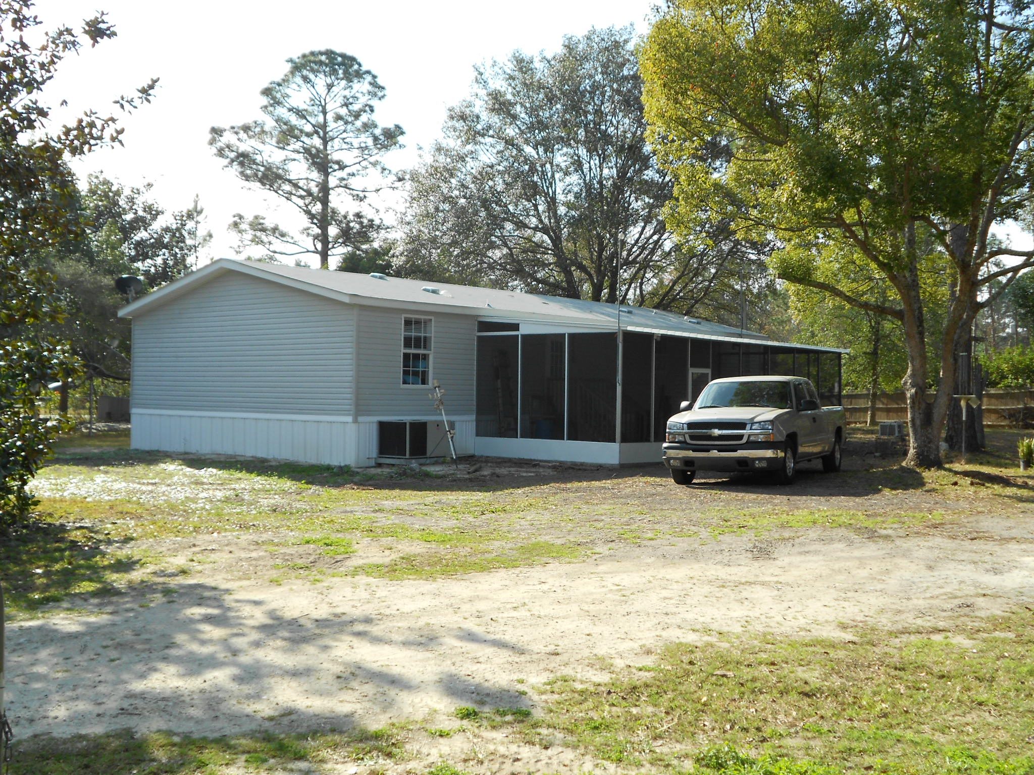

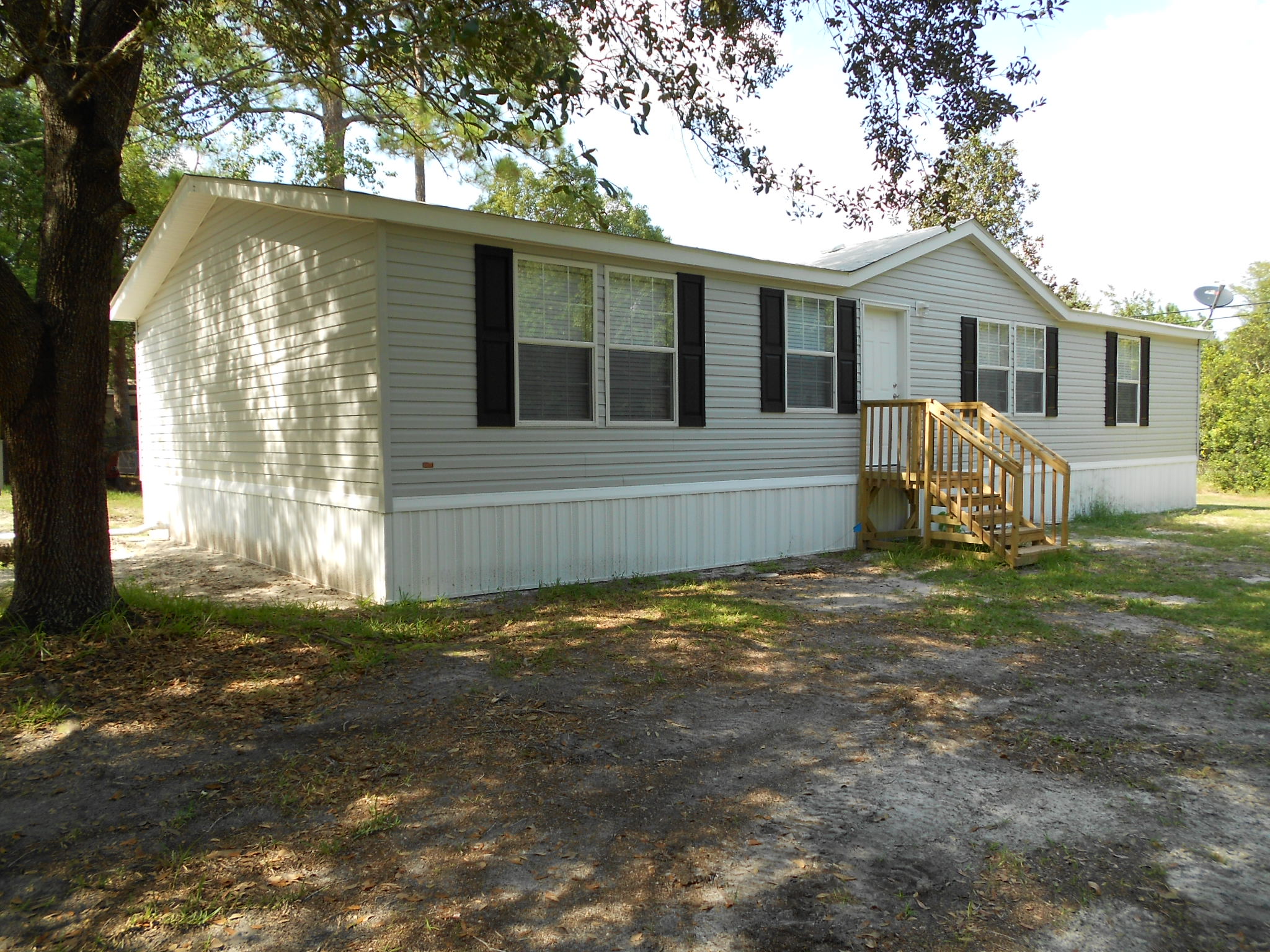

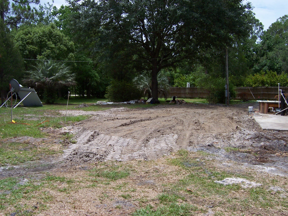

Here in Florida the plastic is required, they call it a vapor barrier.
Also the "Pad" has to be "Crowned" so water won't build up.
I removed a 35 year old 24' X 60' and I had to place 10 loads of dirt (a friend's 9 yard truck) to get above grade for a good crown.
I replaced with a 28' X 56'.
Pics are the pad, rear view and front view after installed.
