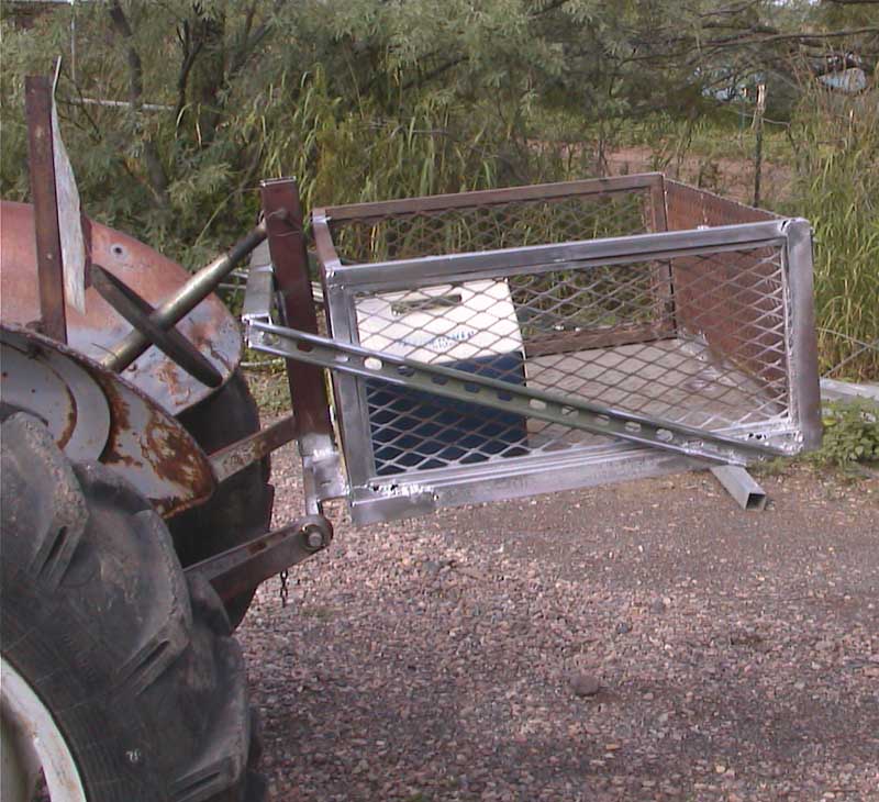

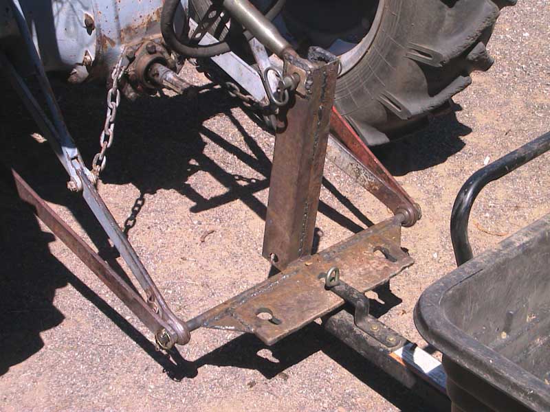

Pins - Inexpensive pins can be made from concrete form stakes. They come in lots of sizes and lengths. I have used them ( 3/4" fit the balls on an old "Fergi. ) to mount a "Carry Box" and for a "Draw Bar". More than ample strength and a very good fit.

If your spending the money to get a new tractor, IMO it's well worth a small amount more money to just get a nice weight box and a few bags of concrete right away. If you will be using a loader, this is a BIG safety item.
