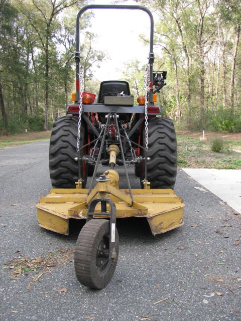

I pull a 48" "standard" King Kutter Rotary Cutter behind my Kubota B3300SU with 59" tire width. I found it derelict and restored it. I can cut up to 1-1/4" brush without straining either the implement or tractor. The 48" width is highly maneuverable in the woods. It has given me no trouble. King Kutter calls my L-48-40 "standard" duty. KK "standard" model would serve you well for the conditions you specified; I do not know tire width of your tractor; you may need a mower wider than 48" to cover tire tracks.
The blade tips on a 48" Rotary Cutter move a lot slower than blade tips on 60"-72"-84" units. While less powerful and slower to mow a given area, 48" rotor expels debris with less velocity, which is safer.
King Kutter makes heavier implements in their PROFESSIONAL line.
