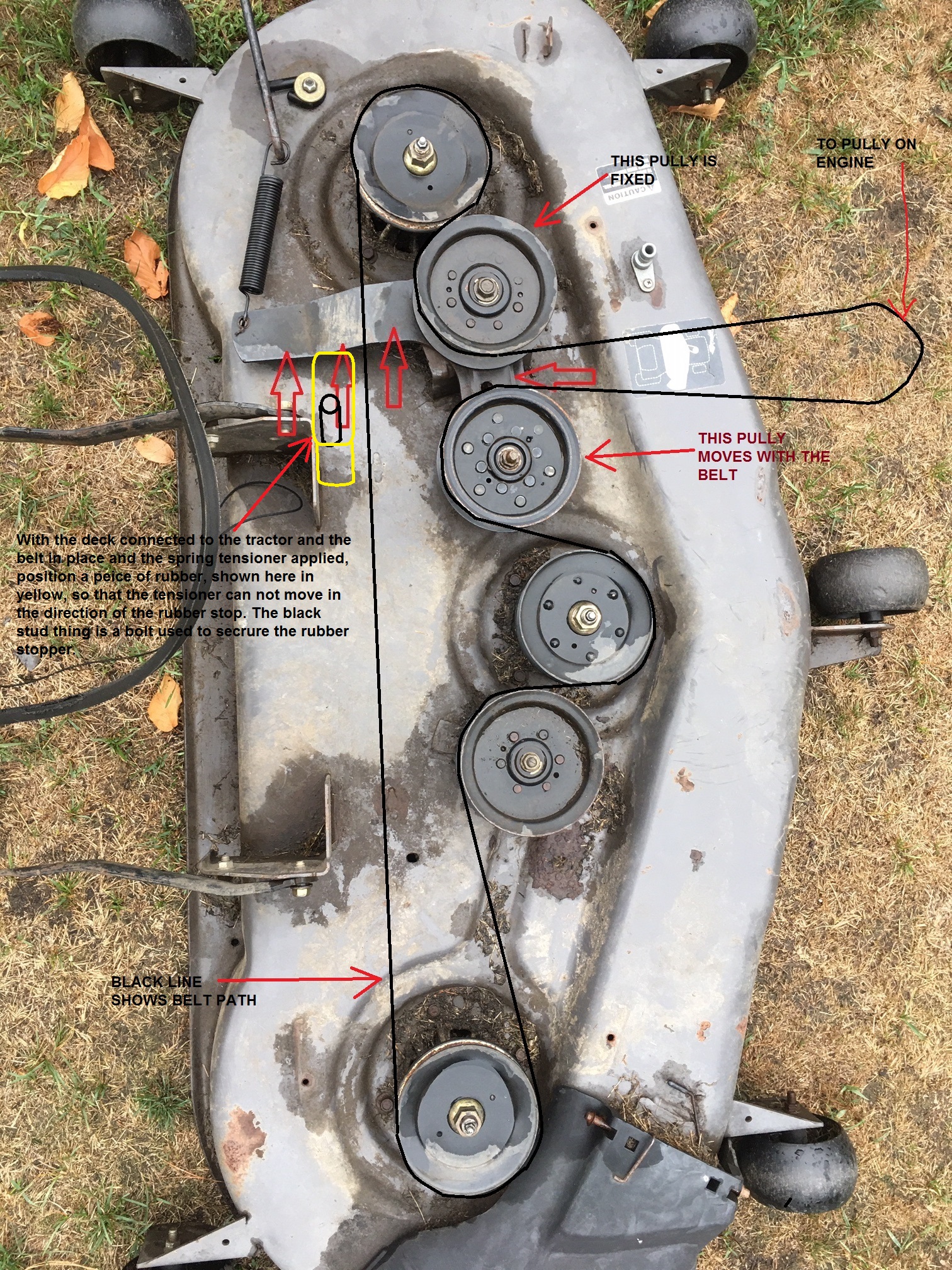

Below is my marked up drawing of your JPG. I noticed that in your photo, the belt guide that would normally be installed on the tensioner pulley is not in place. I assume that you put that in after installing belt on the deck.

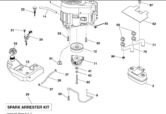

Do you have this item, number 9 in the photo below, attached to your engine?
The belt that is used on your mower is long. Power pulses from the engine and load variations from the mower blades can cause the belt to stretch and then relax. This will cause the belt tensioner to move around a lot. It only takes one loose moment for the belt to jump off one of the pulleys.

Great notes/graphics overlayed on my JPG. Yes, I have part #9. Yes, I have my belt guide on the tensioner - just not in the picture. And Now I understand how to setup the additional guide with the rubber stopper - I'll get right on that. Thank you.

Richard. I mowed yesterday with NO JUMPING. Not really sure why, but, I did take the tensioner arm off, clean everything, actually removed the old washer and put a rubber one in it's place (don't ask - I thought it would take the tiny bit of slop out of the arm) and then I did bend the arm up, with the pulley that you noted "moves with the belt", just a little so that it was ...reaching up toward the engine/drive pulley. I also did not lower the deck below 4.
I'm going to setup that rubber so that the tensioner arm can't ...over extend itself. Thanks so much!
