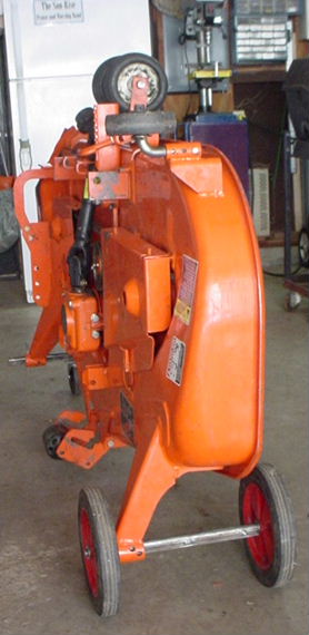

The way that my mower deck is shaped, the small mower axels wouldn't work. I had to make my own for clearance.
Ended up with a "Tricycle" setup. I used a pivoting dolly wheel for steering. it's nice to have the room with the deck vertical.

   / Mower deck mover #17
Tom_H said:
........... I have a dolly made of 1/2" ply and 16 2" swivel casters. .............
I can't imagine why you would need 16 casters. Could you please post a picture of the dolly in use and the bottom side with the casters. thanks
