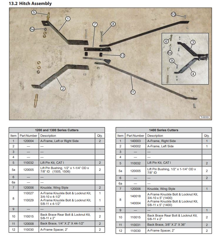

Is that A-Frame supposed to be able to move independently of the mower? If not, weld the A to the Mower, and that eliminates a source of twisting that is likely loosening the pin/nuts. I'd also be looking for a longer lift pin, and double nut it on there, plus probably just weld the bushing in, and possibly even plate it. I don't like tack welding nuts since that is too permanent, but there are plenty of good lock nuts available... For this kind of gear, I like distorted thread, or flex top steel. As much as I like nylock style nuts, they don't really grab well enough for this situation.
Honestly, I think welding the A to the mower would do it though. I don't know how it get significant rotation force against the pin/nut once that's solid.

My mower which I think is a maybe 10 year old Titan has arms that pivot. That whole A frame is supposed to pivot to allow the mower to follow hills and valleys. You can torque those bolts a bit. Like 435 lb/ft of torque. My Titan manual shows those bolts with a bushing for the A arm so the bushing fills that big hole and is a bit wider than the A arm material so the A arm can swing.

My mower which I think is a maybe 10 year old Titan has arms that pivot. That whole A frame is supposed to pivot to allow the mower to follow hills and valleys. You can torque those bolts a bit. Like 435 lb/ft of torque. My Titan manual shows those bolts with a bushing for the A arm so the bushing fills that big hole and is a bit wider than the A arm material so the A arm can swing.View attachment 760535
That is exactly what I wanted to know. Thanks a ton for posting this. It sorta confirms several things for me that I suspected but was not sure.
I do have that bushing "5A" which really confirms the need for the A Frame to be able to move like you mentioned. But in doing so, it makes it almost impossible to be tight enough to keep from - eventually - working loose.
So I have decided to spot weld the pin to the mower support. This will keep it "true" and as long as the welds hold it will not be able to wobble. I got hardened grade 8 oversized very thick washers for the threaded size and wrenched it down very very tight. I used Loctite on the nuts too.

I have a Titan 1206 Mower that I use with my JD 4520. I use Cat1 pins. The problem is that the lift pins on the mower are always coming loose. The mower holes are 0.9" and the Mower A fram arms are 1.3" I use a bushing in the A frame holes to reduce it down so the Cat1 pins will be tight. I use locktite and lock washers. The pins still come loose.
I thought about using Cat 2 pins, but of course I would have to drill out the holes in the mower to fit the large Cat2 pins. I am not sure this is the solution. See pics please
Probably the best advise would be to use thread locker (large bolt) to keep it from working loose.

Longer pins and double nut is what I used to solve my problems. Then you can snug it up and allow the space for the frame to move. The double nut keeps things from twisting apart.
