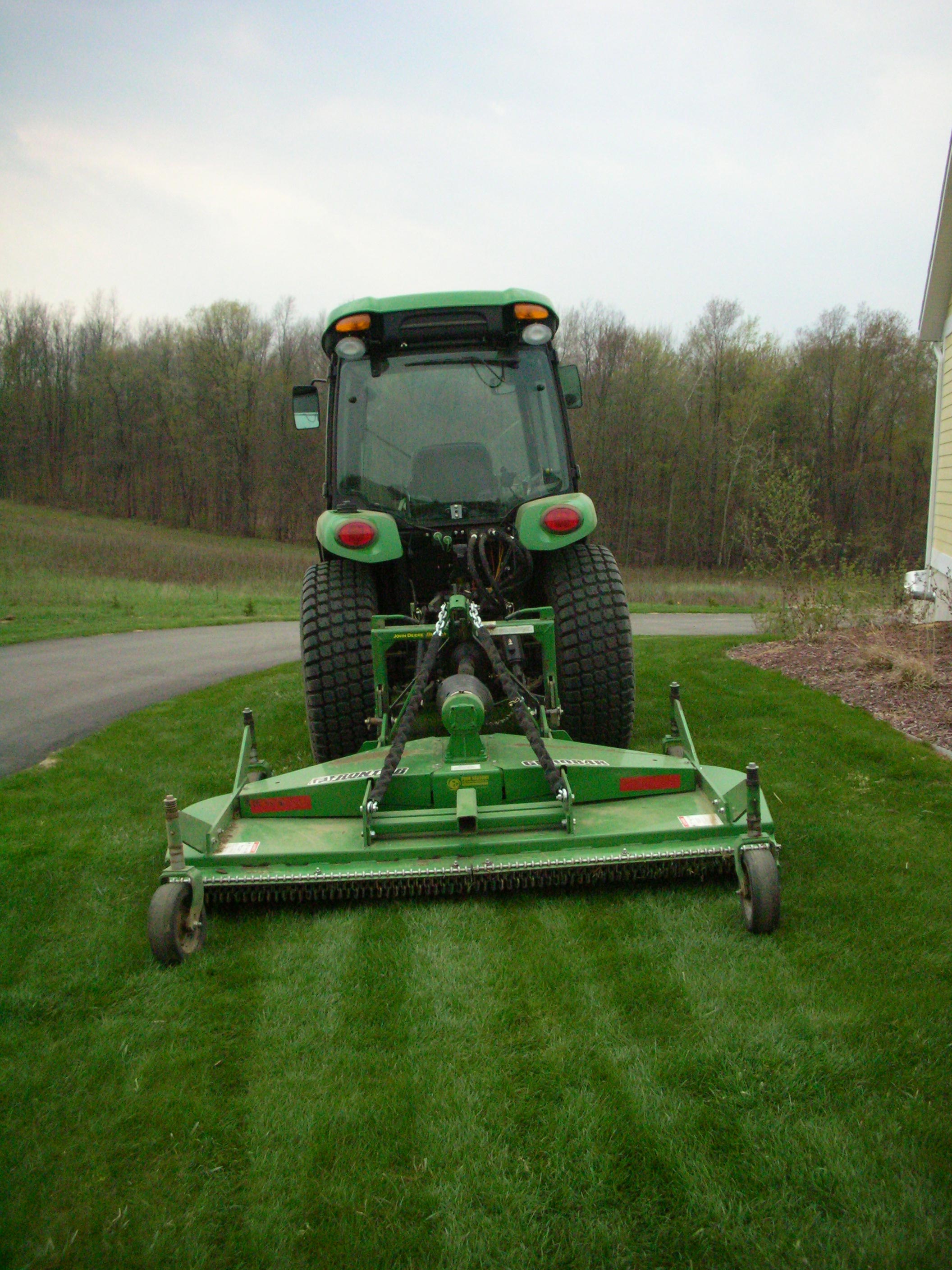

Heres my 2 cents. I'm currently borrowing a Frontier 84" rmm from my dealer. The quality of the cut is pretty good on level surfaces. On any uneven terrain the quality drops. Mainly because the size off the deck. Also the four castor wheels seem to dig into the ground when going from forward to reverse and vise versa, so using it around trees really tears the grass up. Forget about using it to edge with, it just takes to long and is too imprecise. However if you just want to use it for mowing pasture with no trees I say go for it. It will mow a ton of grass in short order. As far as build quality of the frontier. It's build like a tank! Much heavier than my brush hog. Also I like how it hooks right up to my Imatch in just a couple of minutes. I really can't wait for my mmm to come so I can put the push mower away.

What's the "receiver hitch" looking dealie on the back of that GM1084R? Is it used for hooking the mower up in a gang/batwing configuration or something?
/ Mower Options? #8
I asked my dealer about that too. He uses it to tow a roller behind the mower. Kills two birds with one stone type deal. He puts on a charity lawn mower race here at the Sparta airport in July. All proceeds go to help find a cure for Huntington's disease. I've volunteered to mow about 10 acres out there 4-5 times this season. I thought it was the least I could do for using his mower this season.
