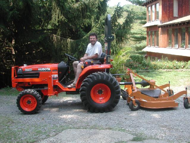

Hi,
I went with a RFM and I am basically satisfied with my decision. I have only used it twice so far.
At this point I think I should have went with a 72 inch unit over the 60 inch that I bought. I have a little extension beyond the rear tires, but could use more. I like the rear discharge that I have, which is a Woods RD6000 model.
Cutting close to a fence takes a little getting used to, as the movement of the mower, as related to the steering wheel, is opposite to that of the MMM. In other words, the MMM moves with the front wheels, the RFM opposite to them.
THe RFM goes on and off pretty easily. Actually really easily. I have to drop my backhoe to put on the RFM, and that is the hardest part of mowing.
An advantage of the RFM that I liked was the ability to back to a ditch and cut right to the edge. BUT, to do this you have to pick up the RFM with your 3PH, because in the normal mode the RFM runs on the ground, supported by its own wheels, and the back wheels will drop off the ditch edge otherwise, sending the blades into the ground. [I figured this out beforehand, so I did not do any rototilling...]
With a hst transmission, I don't mind stopping and backing up in some tight places. A real pleasure as compared to using the old MTD garden tractor.
All in all, I think going with the RFM was the right decision for me. IF you go with a RFM and regret it, you will likely be able to see it much easier than you could sell a MMM, which is generally brand specific, from what I understand. THe RFM is a 3PH attachment that will work on just about anyone's tractor.
The RFM does stick out the back a bit more than I had expected, but I don't find this to be much of a concern, if at all.
Attached is a photo of my B2910 with the RFM on it...
Bill Macher in Pgh, PA...
