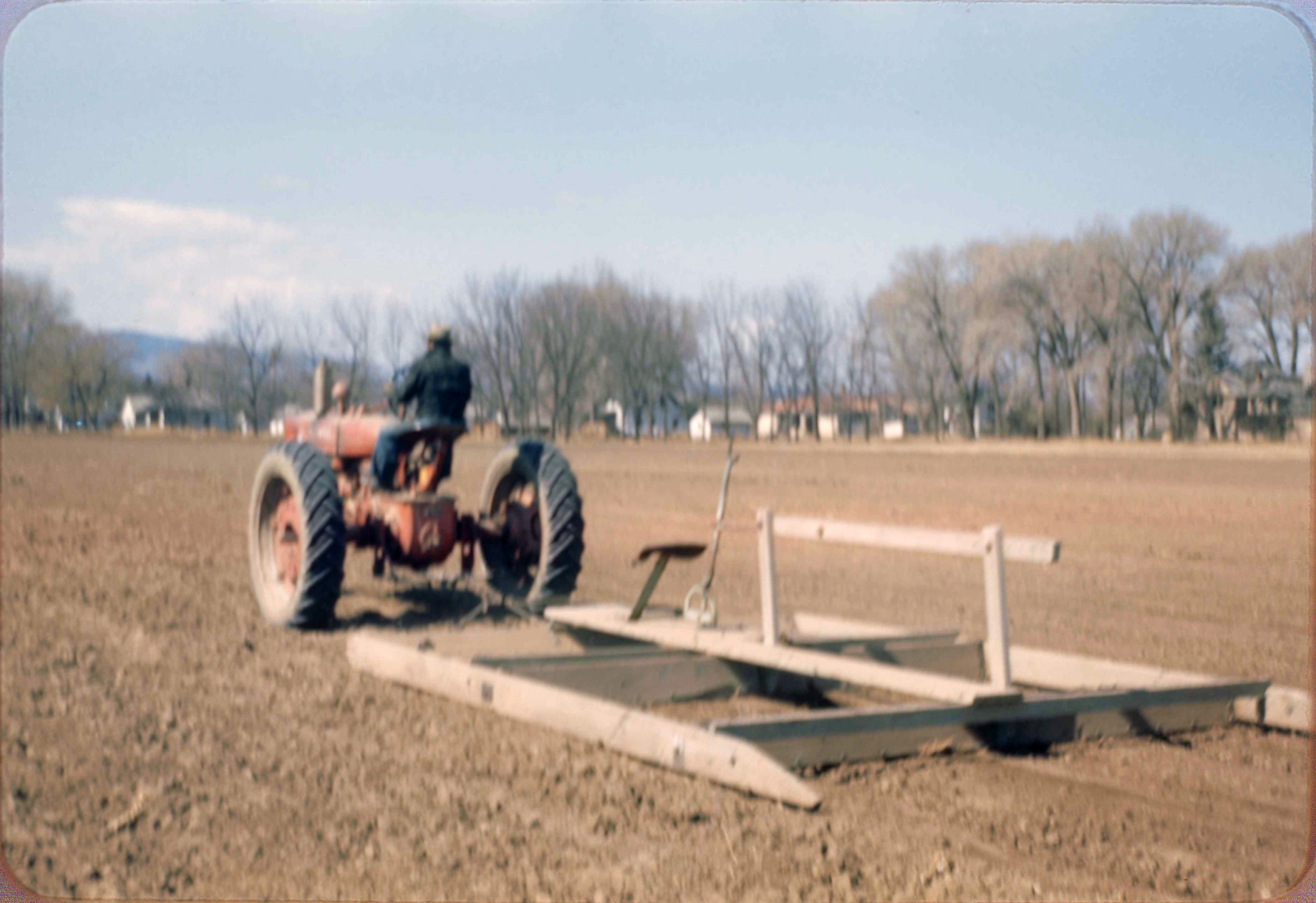

The way it used to be: Disk it, then float it. We weren't leveling, just smoothing.
We would also disk it, then drag a long beam or rail in crossing directions.

On 50 acres I would build and use something like bcp show in his picture. My 84" LPGS would take just too long. You need something to drag that is 12' to 16' wide.
Make a drag out of two large logs - some chain - a wide bridle.

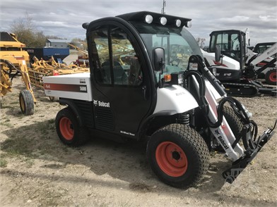

Bumps is one of the biggest reasons I switched to a Toolcat. It handles skid steer implements up front, has a pto and 3pt out back (5610), has 4 wheel suspension and all wheel steer. I too planted forage and prairie grasses where I had 1800 trees removed.

I see they have a suspension, but still pretty small (tiny) wheels compared to a real tractor.
Nice machine no doubt but kind of pricey.

Yes, the tires at 27/29" are smaller than many tractor rear tires, including the TC33D I had, but there is no comparison between the two on ride quality. It's like comparing a hay wagon to a modern car.
