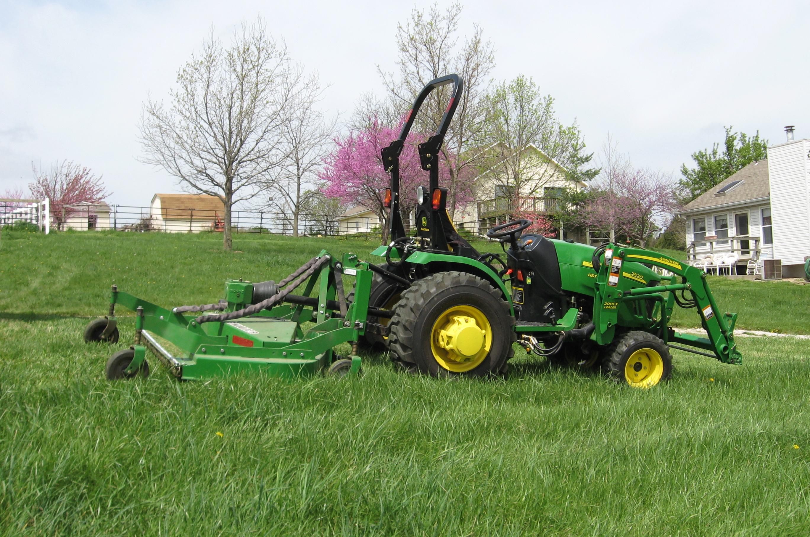

I have a 2520 with both a 62D and a 72 inch rear finish mower, Frontier GM1072R. I have found exactly the same thing with this setup, i.e., on uneven terrain, the belly mower leaves an "edge" of grass sticking up. The rear finish mower solved this problem completely and delivers a golf course smooth cut. I believe this is because the mower rides on it's own wheels and follows the terrain better.
I have been very happy with the rear finish mower and if doing it again, that is all I would have. 100_0703 B.JPG
