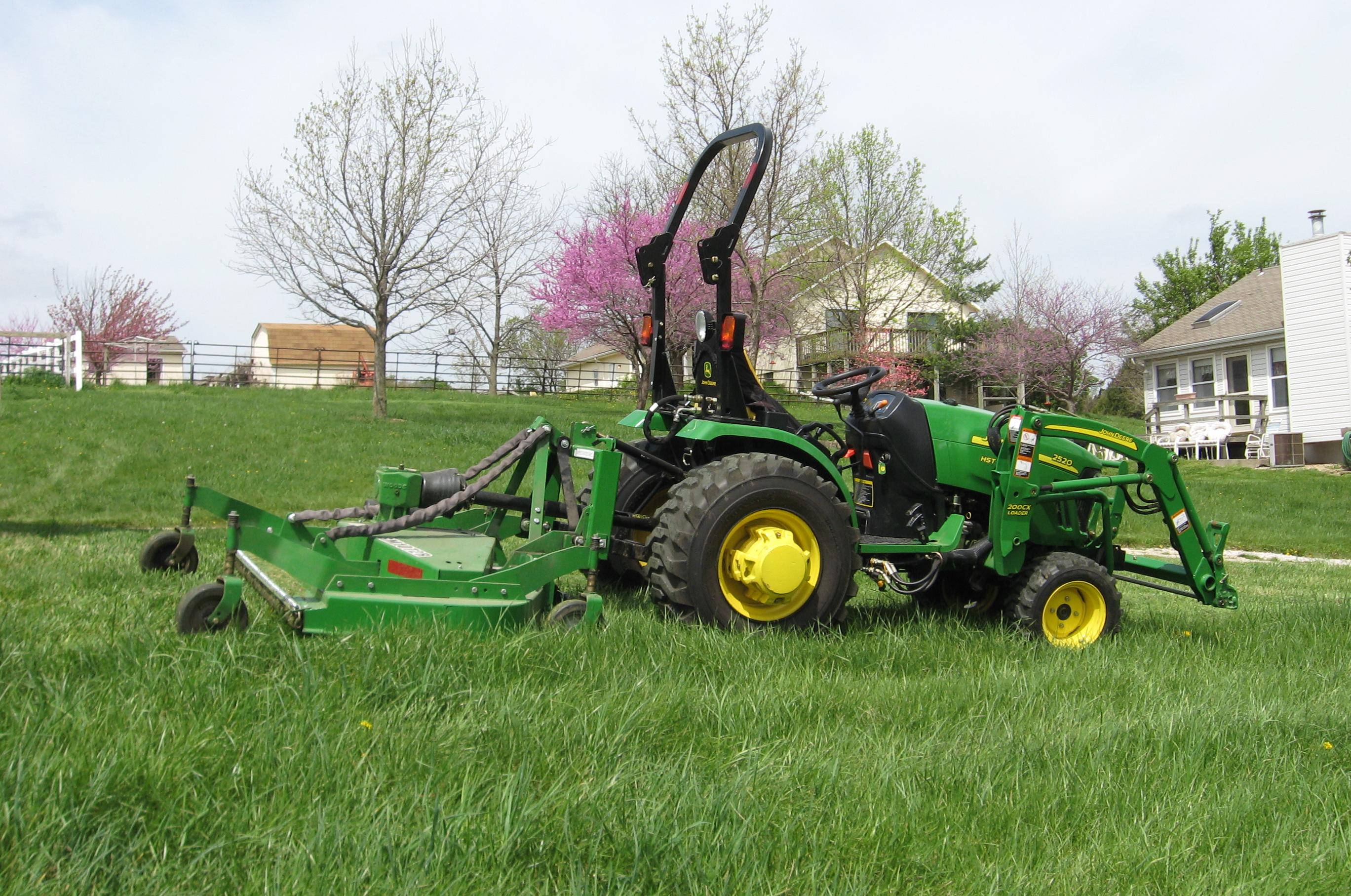

I have a 2520 with both a 62D and a 72 inch rear finish mower, Frontier GM1072R. I have found exactly the same thing with this setup, i.e., on uneven terrain, the belly mower leaves an "edge" of grass sticking up. The rear finish mower solved this problem completely and delivers a golf course smooth cut. I believe this is because the mower rides on it's own wheels and follows the terrain better.
I have been very happy with the rear finish mower and if doing it again, that is all I would have.View attachment 294568
Runner, I totally agree! If you leave the 62D follow the contour of the ground it makes a beautiful cut. But we know we can't do that! Your experience with the rear finish mower makes me think this might be my way to go? Do you find the RFM leaves an uneven cut or scalpes when the contour changes? Looking at your photo, your yard contours are similar to mine, I only have less slope. Having no experience with RFM, I assume the wider you go the more uneven cut? Your grass looks very high? Does the RFM bog down in the high grass?
