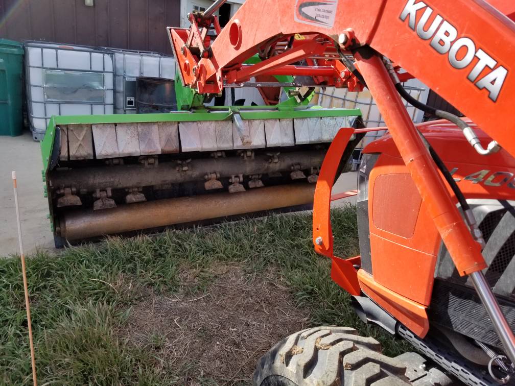

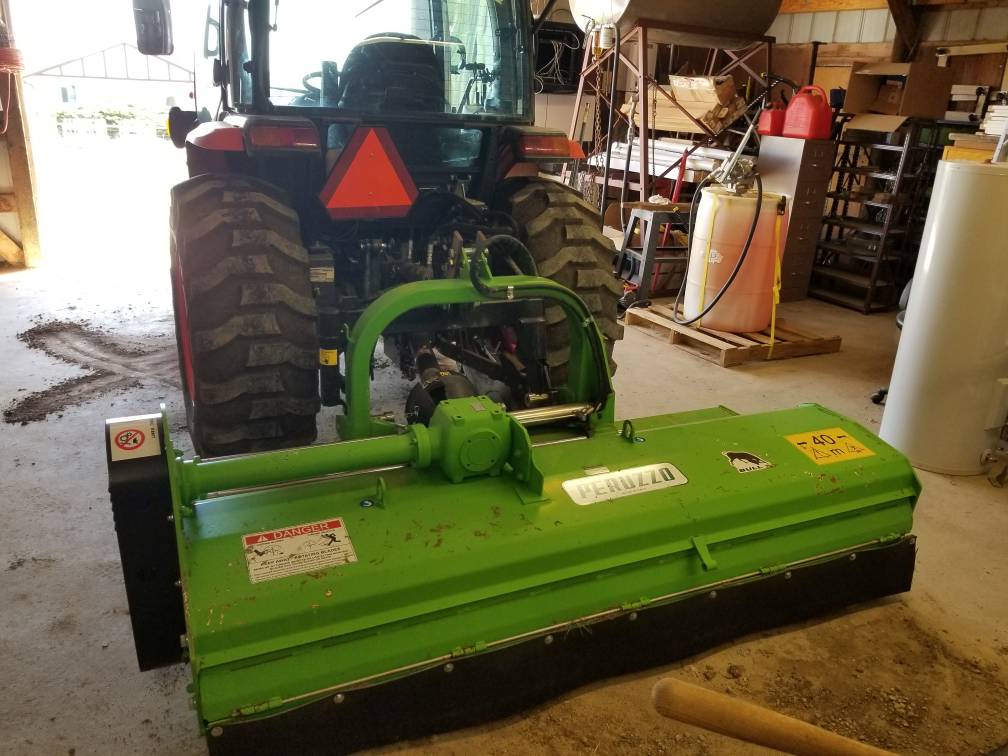

My green Peruzzo Brush Bull will mow Christmas trees. The L4060 is a little weak on power for that & its noisy. But it gets the job done for occasional small trees that are dead or 9n the way. I can imagine it would be great for mulching limbs & pruning debris in an orchard. Unlike the old Ford, my Peruzzo was not cheap. Its also dubiously to big for a Grand L.
Side cutter knives tip out at finger sized material. My ancient beat to **** (bought for $100) yellow Ford 917 flail would do brush ok, but woody thing much over finger size would just get debarked & mangled, not really cut. Hammers are needed for bigger material. 20190505_122945.jpg20200419_165207.jpg20180509_190637.jpgIMG_20150626_200301.jpg20161025_152850.jpg

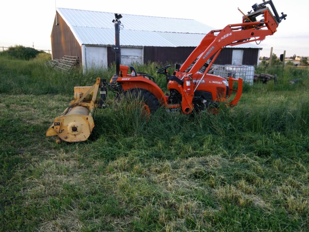

I use a Woodmaxx FM62 flail with Y blades for cutting my meadows down once each year in late Summer or Fall. I'm happy with the cut quality and find it much easier to use than the RC I used to have. Somewhat gradual turns I leave it down but while making a sharp turn or backing up I lift it up a bit then drop it back down which isn't a big deal. One nice thing is how much smaller a flail is compared to a RFM or RC, I store mine (along with bucket and rear blade) on the edge of my carport between the posts.

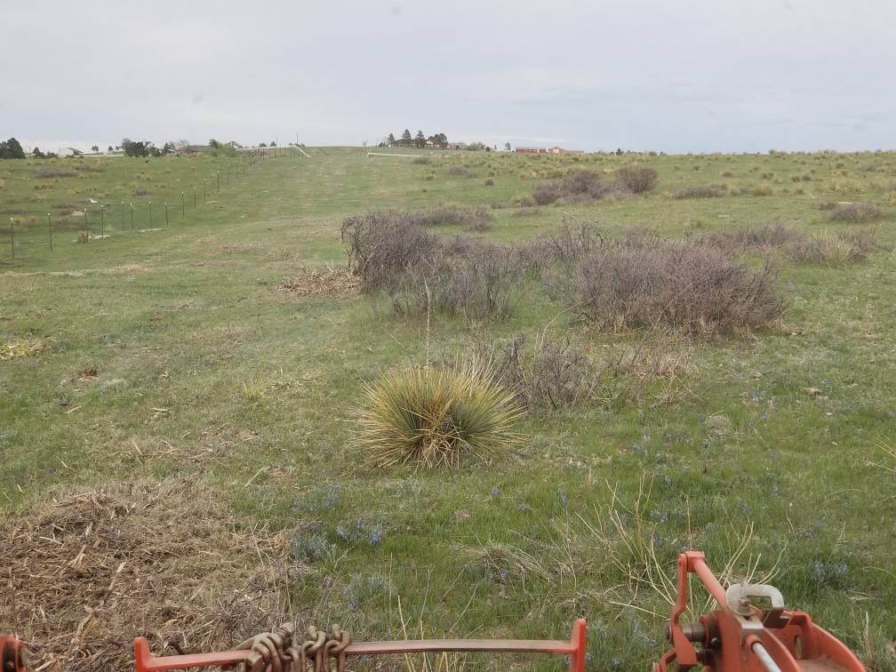

Thanks for the testimony and the pic. How do you like the cut on already well kept grass. I am used to cutting about 7 of those acres on a regular basis to keep the rodent and tick populations down. What kind of speed are you traveling on the once a year meadow vs the well kept grass?
I normally cut my grass with a ZTR but early on when I got this flail I played with it on grass. It actually cuts nice and the lower the better. In the pic I have set as high as it goes for the field but set lower on grass it seems to generate more vacuum effect lifting the grass as it cuts, and mulches better too. It looked much better than the field pictured but not as good as the ZTR, and certainly not as fast, but I would be perfectly satisfied with it.
Given I only mow the fields once a year I do it in low range so fairly slow especially in thick sections. I imagine I'd use mid range for cutting something like 7-8" grass down to 3".
