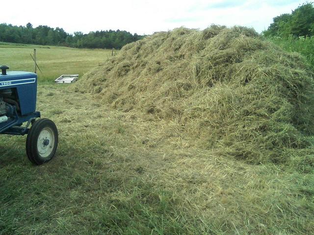

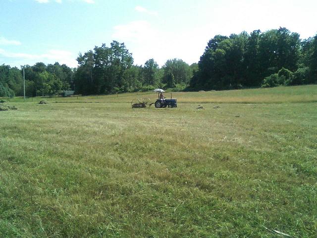

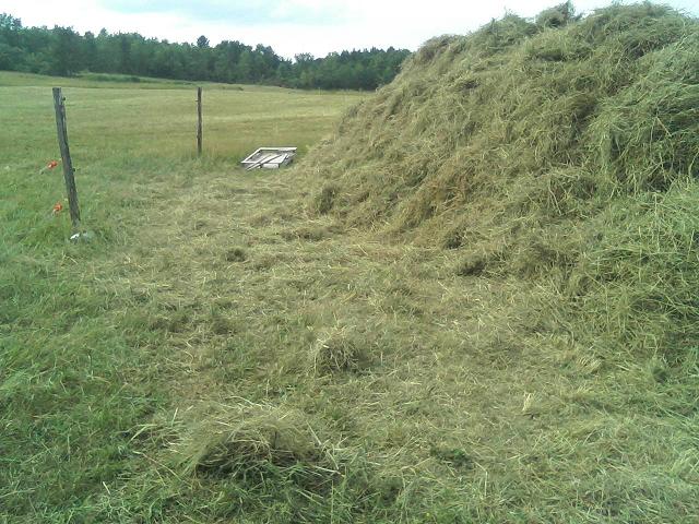

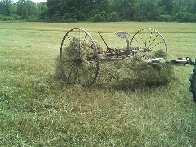

Some good points. However, if I didn't let me son do anything dangerous that i've heard of kids getting hurt or killed he wouldn't be able to do anything. He wouldn't be able to ride his dirtbike, or the tractor, or go swimming, or cross the road to get the mail or climb a tree with loose clothing. I believe when it is your time to go it is your time. I put my faith in higher powers. Getting back to topic, here is some of the finished product. Worked pretty good. Took about 3 hours to rake together and pull back to my haystack with the dump rake.
I would've loved to see my grandfather's face while we were using his old dump rake. I'm sure he was smiling down from above.

You know someone had a rake like that in there yard(deco.) and we were talking about it and they asked me how it worked I said heck I dont know:D but thanks for posting pictures,I now know....

Not to tell you what to do, but if you don't stack that in a more vertical pile, and comb it down, I'm afraid you may lose a lot of that hay. I Googled "Making a Haystack", and here is a link to a pictoral of making one. Making a Haystack
Yep, pretty work intensive, but just hate to see you do all that work, and lose any more hay than you have to. Piled like that won't shed much rain/snow. Plus, all seed heads may start to sprout, and make it even worse. Then you have a large pile of grassy mulch to deal with. It will wick ground moisture up from the bottom too.
As mentioned before, we used a large tarp to cover ours. A cheap alternative now, is to find a sign company that uses plastic tarp like material for their roadside signs. Around here, they give the old ones away, to anyone that will take them.
Let me tell you my grandfather would've gotten such a kick out of us using the dump rake. It worked much better than I had even hoped. It was picking up some huge haystacks and dragging them back to the main haystack. Some of the turns were packed so heavy in the dump rake that it took some muscle to dump it. We had to use a temporary strap to hold down the foot lever to keep it from dumping in the field(because I was slinging hay instead of riding the rake) but it worked great. My dad had a blast helping, he hadn't seen the rake in action since he was about 10 years old when he used to ride on it.
Yes I will definitely take the time to comb it down. No sense in doing it until I have the other 7-10 acres done and stacked on top of the stack right?:D For right now I do have a tarp on it with the bottom 5 feet of the sides exposed so that it can breathe until the other 7-10 acres of hay is on top of it....
